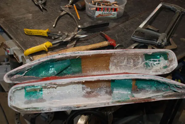

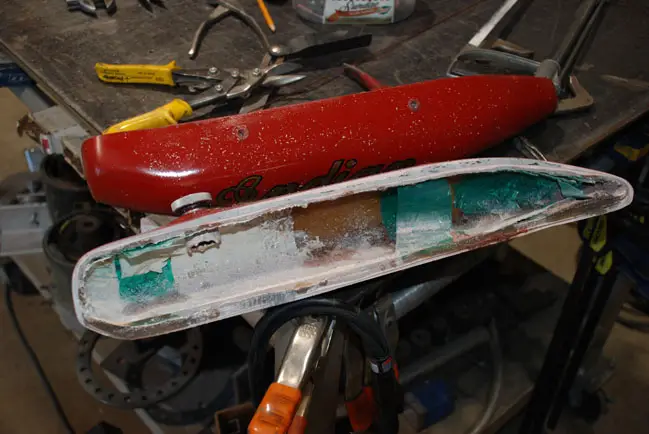

Here is what was on da inside!
ID:	15670   Click image for larger version

That was (is) the tank I had made by the "Professional" out on California. When I got the tank it was completely enclosed. I didn't find out that it still had foam in it until I drilled the hole for the filler neck. I used gasoline to disolve the foam and then sealed it with Kreem tank liner. Unknowingly...I didn't get all the tape out and the liner failed over a short period.
When I shipped the bike to North Carolina UPS damamged the tank and we sealed it again with another product...it failed.
In hindsight... cutting the tank in two and removing the inards would have been the way to go.
It sure looks thick enough!! You can tell where I added some fiberglass resin to the topside.

hay RA just take the tank and sand down the filler to the fiberglass matting ruffly an 1" back from your cutt. clean the enside out and sand it good with 36 grit. get some fiberglass chop mat from your local auto store. and pick up a good marine grade resin.( its resistant to gass)t get mine from tap plastics. lay one layer on the enside of your tank halfs. sand the enside again good with 36 grit and coate it with just resin. glue the tank halfs back to gether and fill the voide ( the 1"eara you sanded the filler off) with chop and resin. seal the tank with 2 coats of red coat you can get it from car quest.
