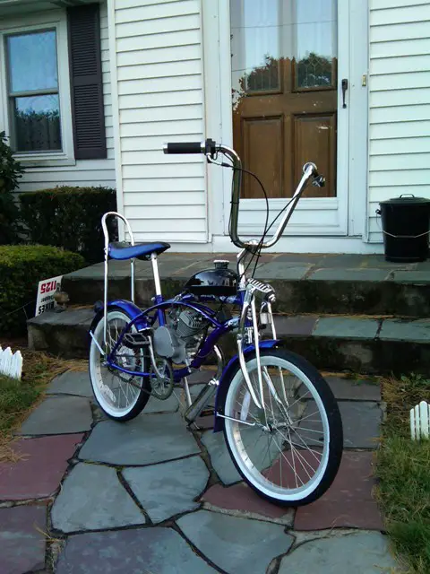

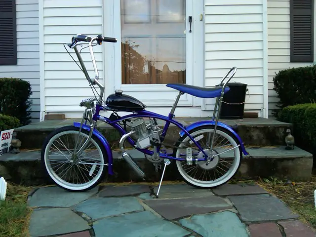

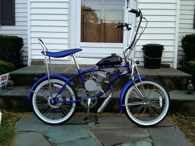

Hello Time Machine from Pirate Cycles,
We build these bikes in our fleet. Piece of cake
You will need to use the 66 cc jet kit with the wide front mount.
Billet intake to drop down the carb.. Loose the air cleaner. Use the fiber and the plastic from the air cleaner, screw it back on to the carb.
Our Sprocket adapter with a 36 tooth sprocket to accommodate the 20 inch rear tire.
Check out the deck mate on our site under complete bikes. Its the same frame as the Schwinn.
This bike can be bought as a diy to your door for exactly $428.98 shipped!
