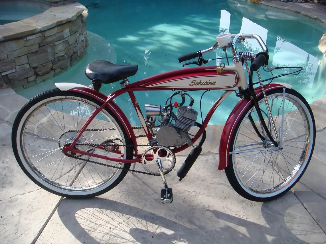

After a little practice posting pictures, I think I finally have it figured out so I thought it's time to post a few pictures of what I've been up to.
OK, so my brother aka Sportscarpat tells me to give up on my Stingrays and go for the 26" bikes and I say 'no way'. Now mind you, I have well over a dozen Stingrays, last thing I need to do is start collecting cruisers. Then he tells me he's building a motor bike and I still don't take the bait. Then he shows his straightbar board tracker build, so I tell him 'maybe I'll do a build'. Then I buy a kinda rough, but original '49 Schwinn cruiser to serve as the basis of my build. Call me sentimental, but I just didn't have the heart to tear up an original paint vintage bike. But I do have this double straight bar frame in the shed.... and you know the rest.
After a month or so of tinkering around, here is what I came up with.
What do you think?

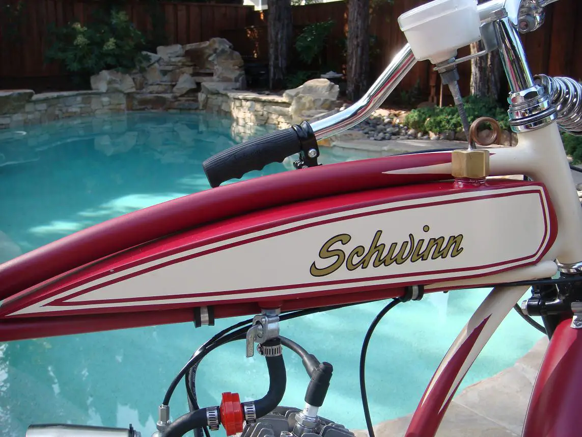

...a few more pic's so you can get a feel for the bike.

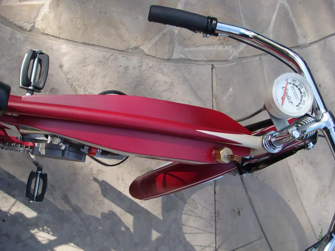

A keen eyed Schwinn enthusiast might recognize the frame, it's actually quite unique. Schwinn only made this double straightbar cruiser in 1962 and it was only used on the Typhoon model which is a middle weight model, but it was generous enough to take the larger balloon tires.

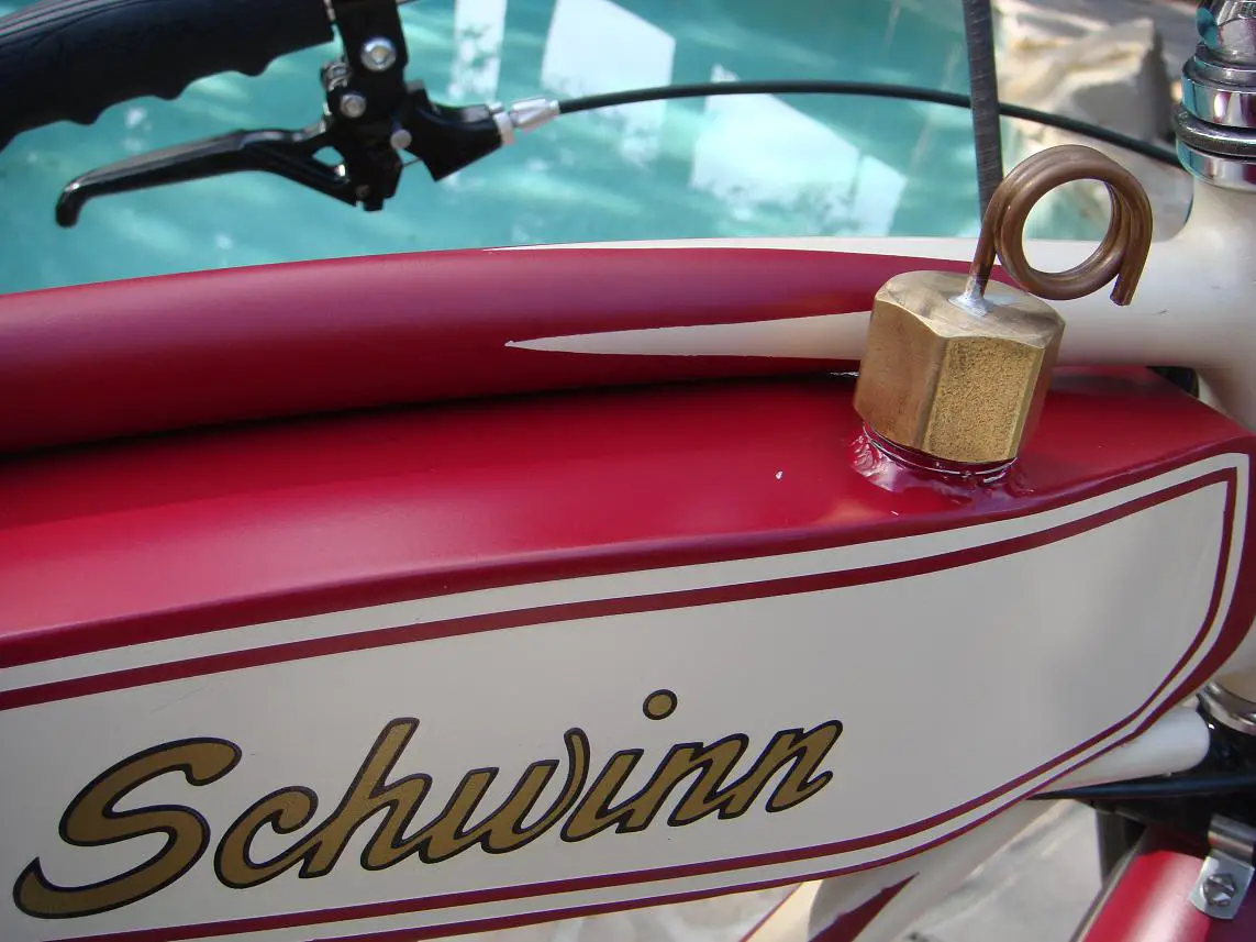

I wanted an in-frame tank to get the look I was after -a vintage old-school look. Having a weldor/fabricator in the family actually comes in handy, and we came up with a custom tank that captured the look I was after.
I stole the theme for the paint job from the '49 and overall, I'm pretty happy with the finished product. Not too bad for a rattle can paint job, escpecially considering I did the bulk of the build with a cast on my arm.

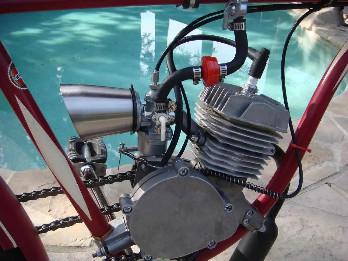

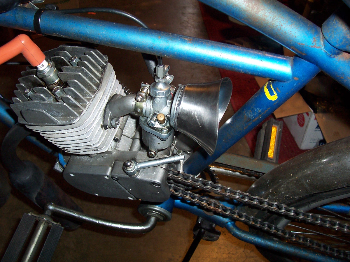

i'm digging the stainless drink mixer velocity stack.
i went with the candle holder.

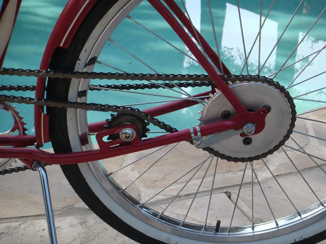

I managed to find a deal on Craigslist on one of the re-issue bikes that Schwinn did in the late '90's. The frame was a tig-welded import job, but all the components were very nice repo's of the orignal hardware from the late 40's and early 50's. I had no use for the frame, but all the running gear was fantastic. The springer forks are simply awesome, and all the little bits like goose neck, wheels, etc. all found a new home. At $150, I scored.
To that initial investment, I purchased a Grubee Skyhawk motor, a pair of Felt Quick Brick tires, and upgraded chain. I used one of 'Sportscarpats' idler brackets (see attachment), tig welded to the top of the chainstay. Otherwise, no mods were made to the frame. The hub mounted sproket assy came from Pirate Cycles.

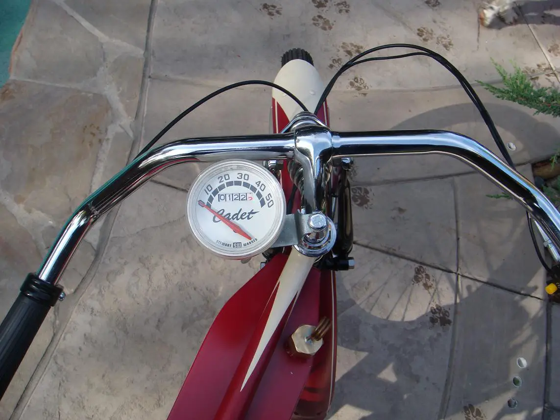

Fenders are from Husky Bikes, only 30 bucks shipped to my door. I cut them down to better fit the project and to give me the look I was after. I had to dimple the fenders to clear fit the frame, but finished, they look pretty good. The gas cap is a 3/4 pipe fitting, less than 5 bucks at home depot, with a handmade breather added to vent the tank. The speedo was a swap meet piece.

Bairdco has a keen eye, he noticed my stainless mixing cup, cut down for my velocity stack. Not many builders can claim they have parts from Bevmo on their ride!

i've got a few of those cups, but i don't have the clearance. then when i happened upon the candleholder with the wings (for 50 cents) i was all over it.
i think, visually, that really improves our engines. the plastic box just looks like crap.

Without a doubt a very sweet ride that keeps it's vintage roots while still being a true hot rod. I watched this build first-hand and must admit that Itchybird spent the time to make this bike right. He designed the gas tank from scratch, built up a few cardboard mock-ups until he was satisfied with the shape and then talked me into welding it together. At first I thought he was crazy with the shape of the tank, too complicated I told him, but once built it was definately worth the effort. As for the drink mixer velocity stack I thought he should just mix a few drinks with it and then buy an off the shelf air cleaner from one of the MB shops. He said it would work and it did. Looks really nice. Let's go for a cruise sometime!
