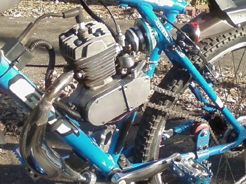

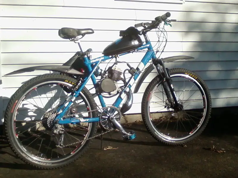

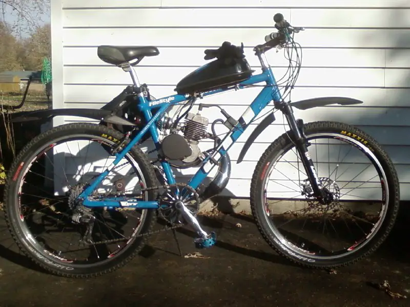

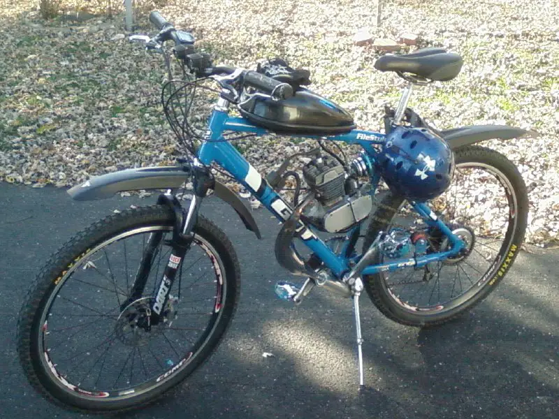

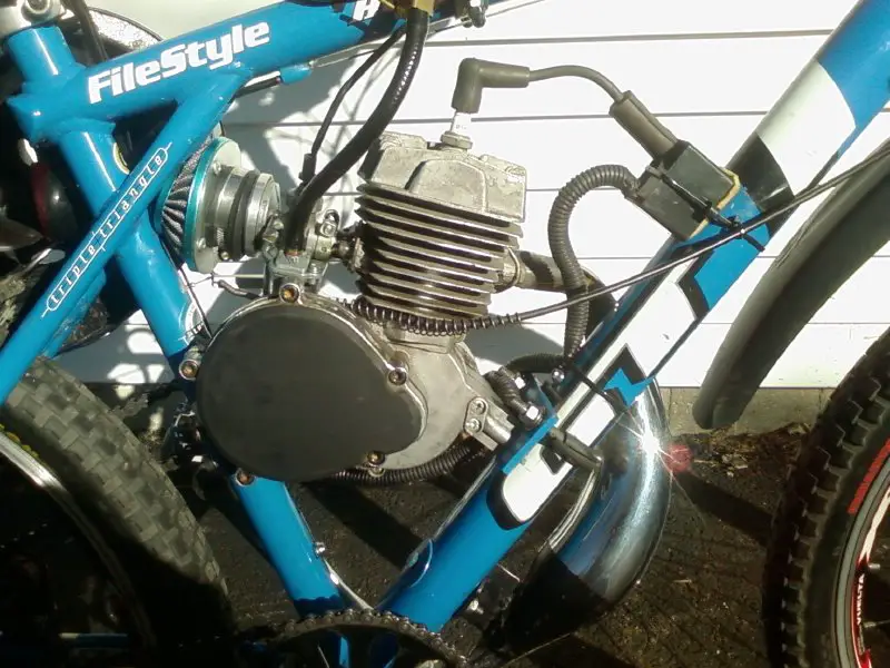

Here are some more pics of my Machine!(L) GT Agressor 3.0 Triple Triangle frame, Kings motor with modified scooter pipe and modified intake. mild port matching at exhaust and intake, stock carb, 32:1 fuel mix, rock shox forks and front quad disc brake, Maxxis Holy Roller Tires on aluminum double wall, flat spoke rims.35t sprocket from Kings sales and service.#41 chain and skateboard wheel for tensioner. niterider LED Rechargeable headlamps, taillight hooked up directly to white wire.the Bike is a easy 30 mph ride and top riding speed 38mph and max speed 41mph. Iam searching also in my area for a flat 1/8 mile road for speed and eta #'s. I Love my machine and I hope you love it too! ant response is appreciated!

Perty sweet!! Is that one of those 4-L tanks that BGF sells?
Old 11-08-2009, 09:20 PM
FileStyle's Avatar
Location: Decatur,IL
Posts: 710
Default Re: A Build that's never Finished
4 liter tank from piston bikes.

did you do any port matching or any modifying besides the pipe and intake aftermarkets? nice build
