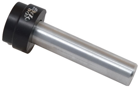

my stock throttle broke, so i got a Sik50s Billet Throttle off ebay for 30 bucks with free shipping.
i had to gorilla glue the stock grip on, but it works great, real simple, and you don't need a hole in your handlebar.
much better response, although it's a little loose.
only drawback is it doesn't have a kill switch. so i just my old busted one, took out the plastic tube, cut the plastic lock pin out, and mounted it next to the new throttle.

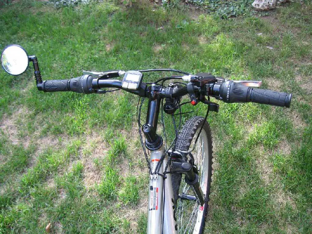

I have had good luck with a metal thumb throttle from Ebay for $12 delivered. The entire housing and innards are metal so it is not susceptible to the normal wear of the factory throttles. I made a new throttle cable for a couple of bucks following Norm's posts. An extra reflector bracket, $2 switch from Radio Shack and some black lamp wire works great as a kill switch.

that's the same thumby one i got. does the throttle cable adjuster screw in? mine doesn't look like it has any threads.

No- I couldn't figure out what threads were on the throttle assembly and the supplier offered little help. I ended up using a dremmel to virtually remove the 'threads' on the inside of of the throttle housing to make a press fit for an adjuster screw.
Go slow and you should be fine. Adjuster screws come in two diameter sizes from local bike shops. Aim for the smaller diameter and settle for the larger if you grind too much.
Stock throttle cable is the wrong length for the thumb throttle. I followed Norms post but I think after I I hooked it up to the thumb throttle and left in a neutral position, I made the other end 49mm off from the cable housing.
