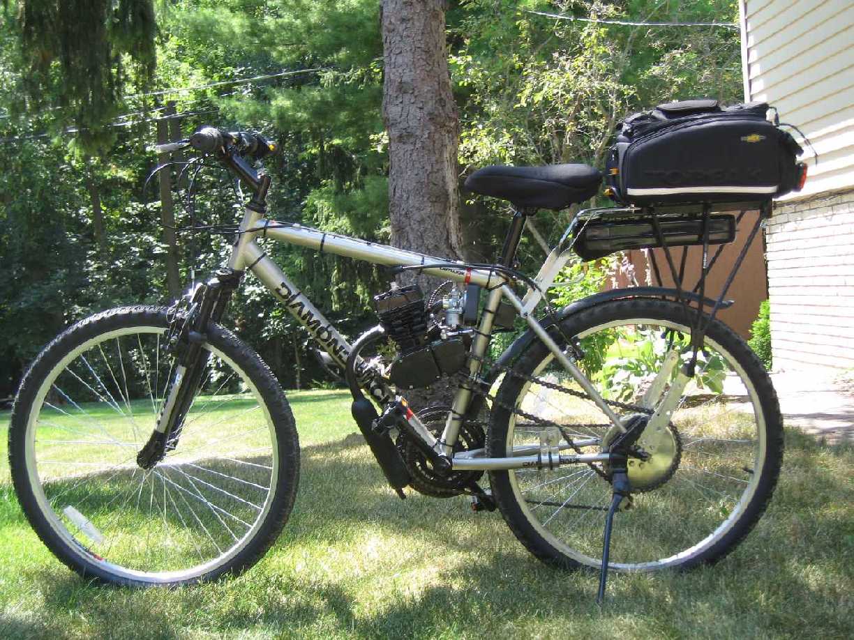

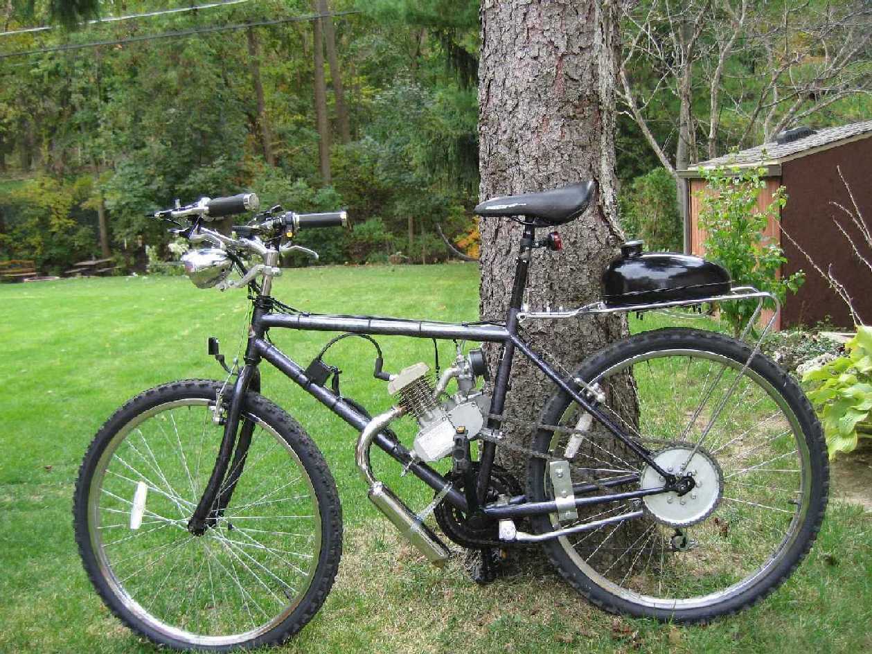

Here's pics of two builds I did.
The first one (grey diamondback) is mine using a rear mount flat tank from Dax.
The second is a build for my father in law using a standard tank on the rear rack.
I prefer the tank in back just to get it out of the way.

wow thats pretty sweet...did the tank tubeing that came with it fit that much and do u lose any gas or anything?????and how did u mount it did u use the bolts its comes with on the tank???
