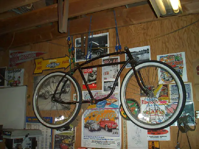

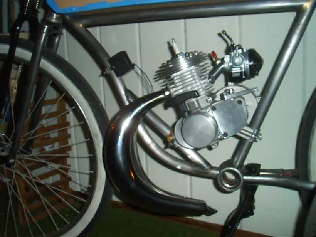

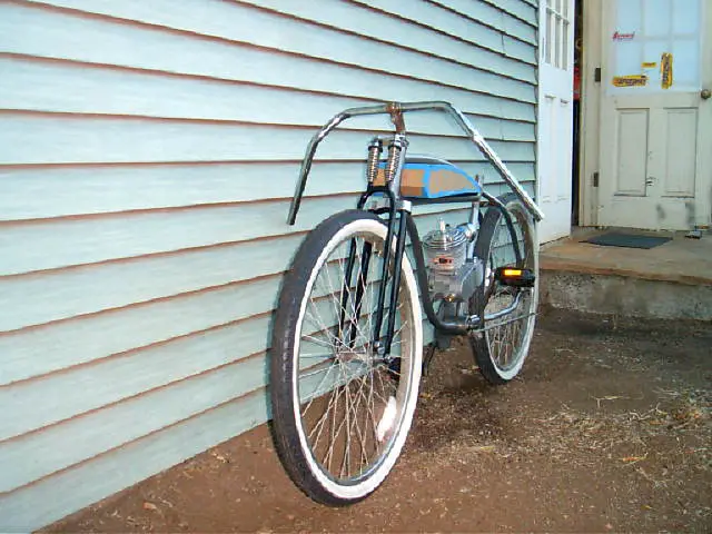

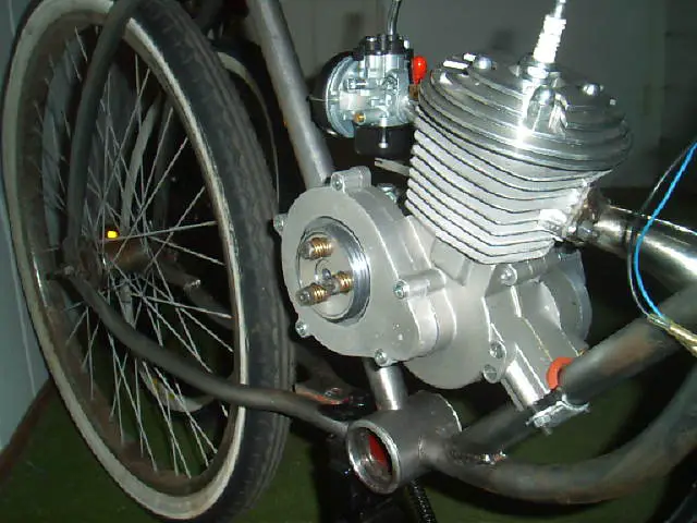

Here’s my long term project, just something to pass the time in my shop. I guess you could call it a board tracker, but I think it’s a little short for that title. It’s an early post war frame I got for $20 and the forks are repop Monark springer. I’ve only gotten to this mock up stage so far, but plans are for a pair of drum brake wheels (black) wrapped in felt tires (cream) and maybe a custom seat. The engine is a 66cc GT5, ported cylinder , coated piston with a shortened skirt, balanced crank and aluminum rod, top hat clutch mod, single “boost bottle”, port matched intake, RSM billet head, Billet clutch actuator, and a few other things I really don’t want to talk about J. I’d love to take it to Death Race next year.

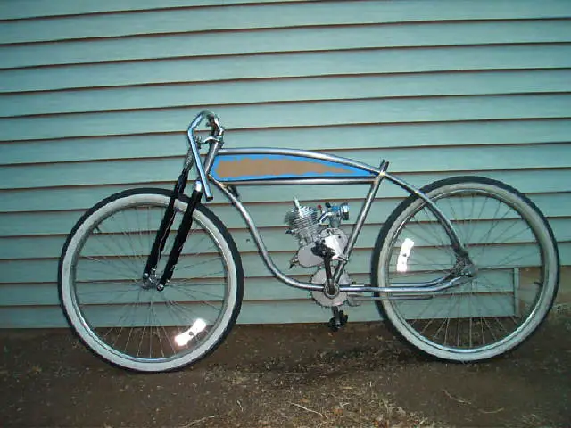

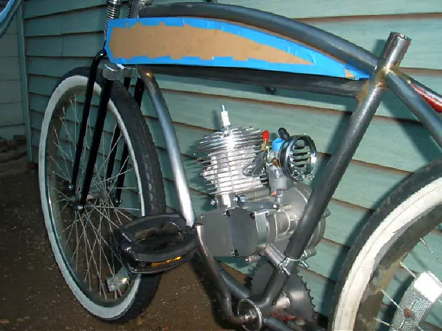

Took the spookytooth chamber off of my other bike. Added pull start and Dellorto carb. I also added an Acme Labs clutch kit (damn nice kit). Hope to get started on the tank soon, but I need to finish a customer's car before I can touch this again.
