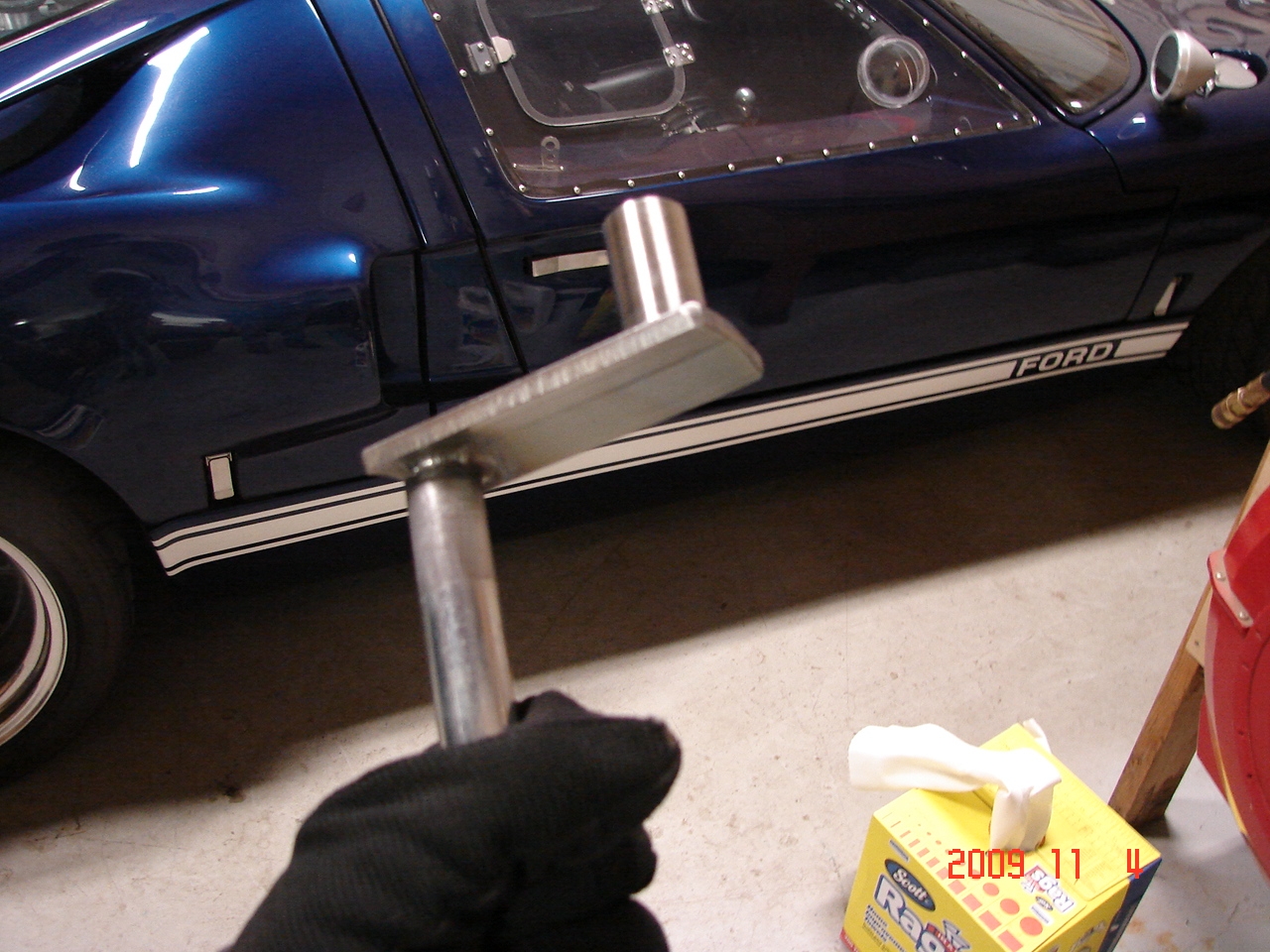

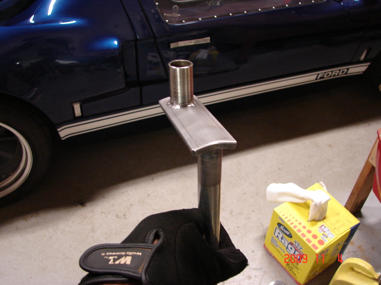

Ever try to find a layback seat post in 13/16" for an old Schwinn? All I could find were 7/8" posts and they were too tall. I finally just built a couple. I would call it more of an offset seat post than a layback seat post. This gets the seat way back at the rear tire. I was worried that the flat bar extension piece would bend over time so I gave it a stiffening break. Time to road test it.

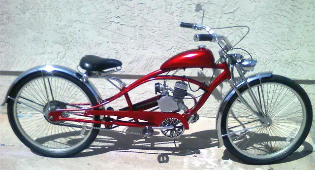

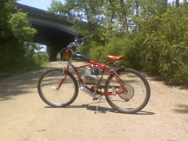

I put a layback post on my stretch cruiser. The post sat too high because of it's support bracket. I just cut the bottom weld of the support and put a rubber end cap on it. The support bracket sits on my frame and allows the post to drop REAL low.

Sweet cruiser, Maxvision. If my attempt starts to bend I may attach struts to the bottom rear of the seat frame and run the struts down to the frame upper chain stays. I was thinking I could use small shaft collars to clamp on the frame then weld the struts to the collars.

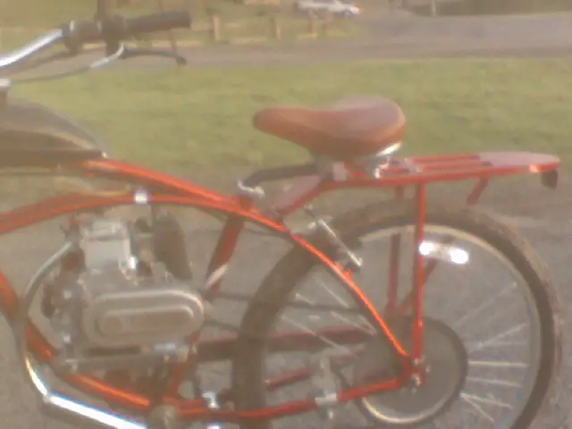

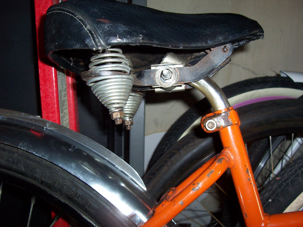

I make my own from 1" shaft stock. I turn it down in a lathe to 7/8" one one end about 7" long, heated and bent to the proper angle. It might be a little overkill but I've never bent one.

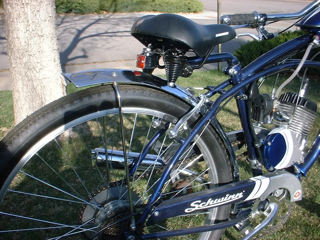

I have one of 2Door's. (Thanks again Tom!) They really make for a better ride.

Hey 2door and bairdco, nice seat post ideas and they look pretty strong. 13/16" tube is just a weird size. 7/8" is pretty standard in the BMX world, or at least it used to be.
