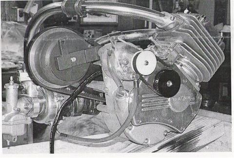

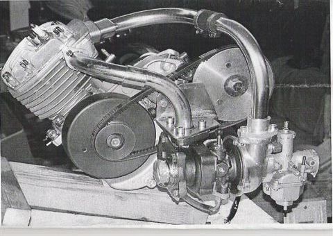

Wanna race? Here's one for ya. Got this recently from Quenton. He said it's from a friend of his. I'm laid off from work since then, saw it & thought "I should post this". Hope I get to ride the finished product.

Good Lord! I really want to hear that thing! How much boost is he running?

were can i find a little turbo like that???

if that turbo's not set up for a suck through system he may run into problems, turbo's that will see vacuum use extra rubber seals in the compressor side. a blow through system dosen't have this problem. looks cool.

Garret makes some small turbos they have one that fits in your hand..
It will work cam he's gonna have to fatten the heck out of his carb tho

Yea, but what flow is it built for?
I know there's been at least a couple US-market motorcycles over the years that had turbos.... but still, you're talking about a 500-750+ cc engine, spinning at 4000-5000+ RPMs. A Whizzer motor is what, 150ccs? And sure as heck don't spin at 6000 RPMs. Who makes a turbo for a ~5hp lawnmower engine?
I'd think it would be way easier to add a blower onto a Whizzer engine than it would be to find a turbo that would really work.

I have several Whizzer motors that easily hit 7000 RPMs and one that exceeded 8200. They are running 26 MM carburetors with a 130 main jet. Stock is 22 MM carburetor with an 84 Main.
Very big numbers for a flat head 138 CC motor. We have managed to get the flat heads to run within a mile or two of the OHV versions.
It is possible to really make these motors "breathe" like never before.
I don't know what the turbo charged motor will do, but is sure is "cool" to look at and wonder the end result.
