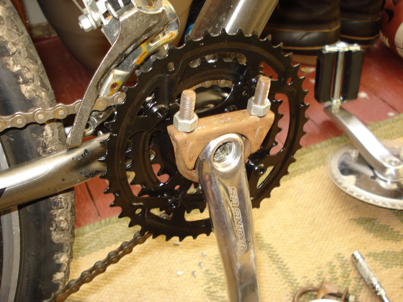

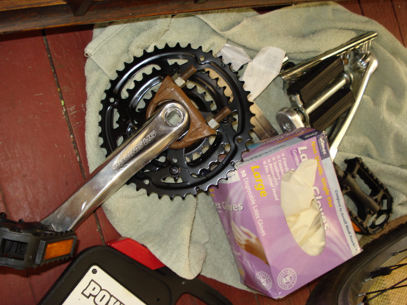

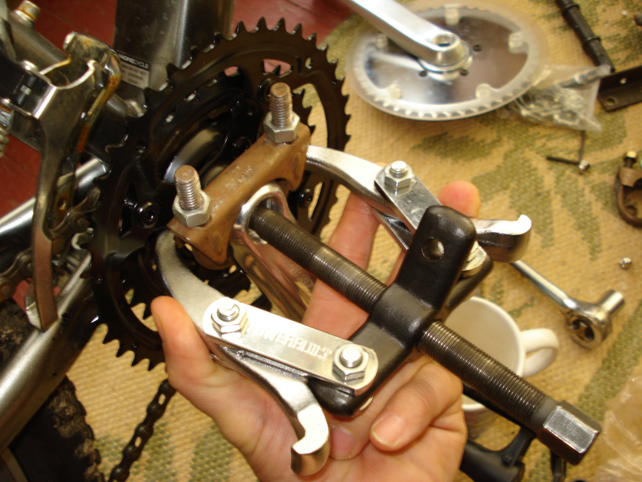

Got a new project started with a sick shift kit. I dont have a crank puller but I do have a 2 or 3 jaw puller, so I set it up for 2 jaw and no problem pulling off the left side crank (no sprocket)... but the right side (sprocket side) was a different story. I tried buying locally and no one has them 22mm crank pullers....the kid that puts them together @ wally world (only thing left in town since they moved in) said he couldnt pull it for me either.
I was finally able to remove It with a 1-3/4" exhaust clamp and the 2-jaw puller. 1st remove the chain guard 2nd place the exhaust clamp as shown in the picture and snug nuts down 3rd hold the jaws together on the clamp and turn.
While I realize this is not the best method in a pinch it'll git'er done.
