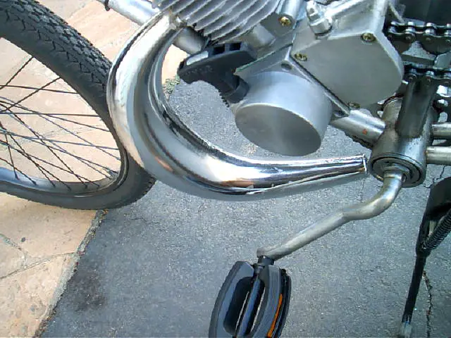

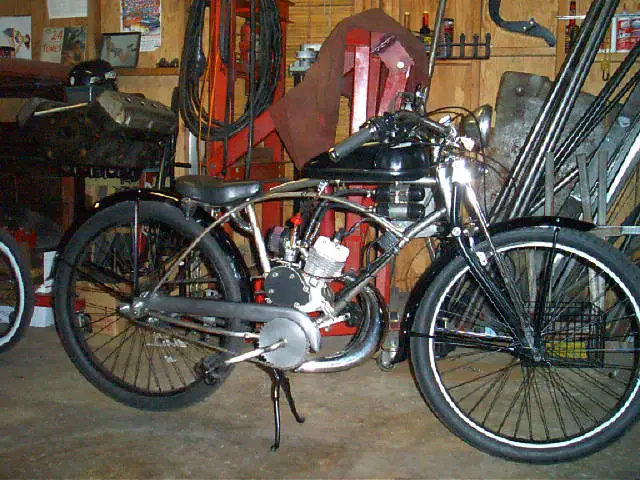

I put one on and couldn’t be happier with the performance gain and the plug burns much cleaner. You get more smoke at idle but it does clear out at speed and depending on your engine placement you may have crank clearance issues. Yes it is very loud and I love it, it’s not deafening, but just loud enough to let the cars around you know that your there. Oh and I think it looks great.

The biggest improvement was mid to high rpm I picked up about 4-6mph. as for the crank clearance I widened them about 2” to clear the pull start and gave just enough room, but it probably would be a non issue on a mountain bike frame since on average the engine seems to mount higher
