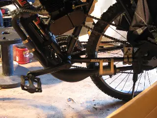

Um... might be better off at an "Industrial Metal Supply" or a general welding shop - even plumbing perhaps. I doubt yer average exhaust shop has the tooling for bending such a small diameter. I'm pretty sure powder coating won't last on such a high heat application either.
All is not lost however - the gauge yer talkin about is pretty easy to bend, just gotta pack it with sand and cap both ends (welded) and you should be able to bend it yourself. The sand is to keep it from kinking - and the exaust shop would have the same problem, with the larger pipe it caves in the side a bit even with their benders - they just don't care with that "large" a pipe.
And ofc any high-temp rattlecan paint will look sweet
Yet - have you checked out this: Sick Bike Parts tuned exhaust? Not only will it give ya the length yer after - you get a pronounced power boost as well...
Just a thought

The two springs on the SBP's pipe are because it's a flexible joint. Common to see on other "small" 2 stroke vehicles like snowmobiles and ultralights, it helps reduce metal fatigue due to vibration and torque flex. It is usually a ball & socket joint, the SBP's one also gives more options for mounting orientation.
There's a buncha sweet expansion chambers out there and a few different styles, I do favor the SBP one obviously

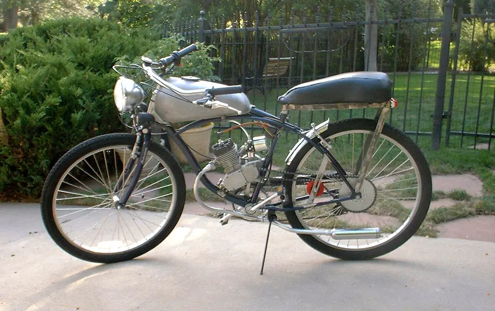

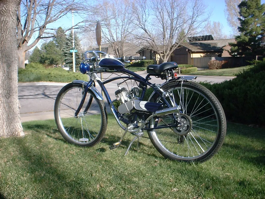

1/2" and 3/4" EMT (steel electrical conduit) works great. Benders are cheap and once you get the knack of getting the bend where you want it you can do almost anything as far as an exhaust system goes. The bend radius is a little longer than I'd like but with some practice you can reduce the radius by moving the pipe in the bender as you go. There's no need for sand or heat. An added plus is if you use new conduit the galvanized coating will take a nice shine with a little work on the buffing wheel and some compound. Napa sells a silver high temp engine rattle can paint that will withstand the exhaust heat even right at the cylinder/flange.
Here's a couple of pipes to give you an idea of what's possible.
