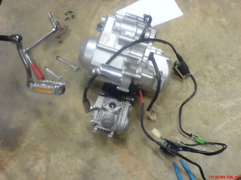

Here's my stretch and the 50cc auto that I'll be working with during the cold season.
