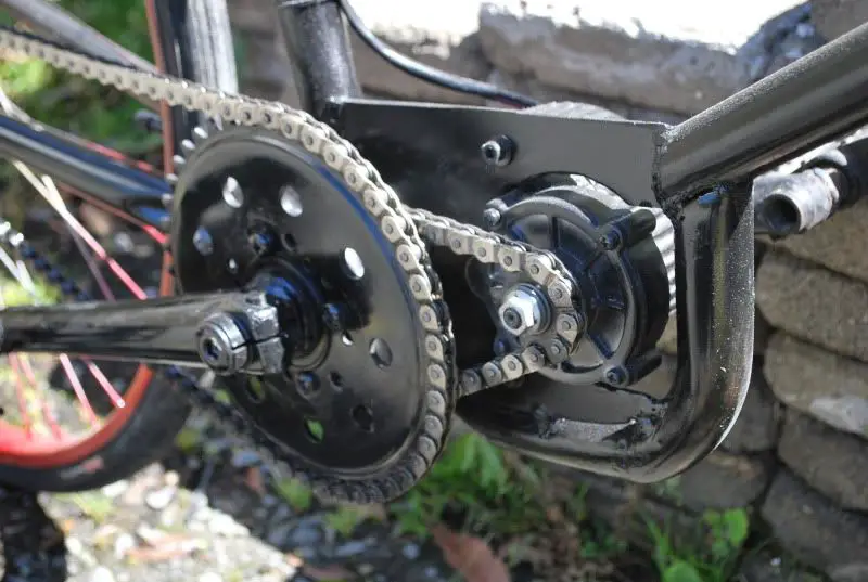

this is my 4th boardtracker, decided to go Electric with a spare 24v geared motor I had..
this is the test run I dod today!!
all is left to do is build a timber veneer rectangle fuel tank to house the 2x12v AGM 7ah batteries and the controller and I am away!!
been a real fun build!!
SPECS
Frame: custom stretched and lowered, BMX BB shell
Wheel, 3sp sturmey archer
Cranks, DK BMX race cranks, freewheel adaptor welded on
Motor: 24v 250W Oatley
Chains - YBN half link chain (no more chain tensioners, perfect chain length every time)
1965 DODGE pickup - the rod
1975 Mercedes W109 - the custom
2000 Hilux - the daily
BOARDTRACKER FOR LIFE!

BARELYAWAKE: chain is super tight from motor ro freewheel crank, once it is slightly stretched should be slightly looser tension (hence stop making the cranks spin)
I wired up the controller and doesnt work, I must have the brake wiring mixed up to the throttle wiring, (very crappy wiring diagram)
anyway, I have made a leaf spring front end and have got a front wheel and some 27" tires for the old girl so Will pull her down shortly to clean up welds and get ready for paint!!
DEACON: this frame was meant for a new freewheel pull start 50cc motor I bought but i started the frame before the motor arrived and wasnt going to fit, then mocked up the 24v motor and fitted perfectly, so make a mount out of 316 stainless plate i had lying round!! and by shear ass the batteries I wanted fitted in the tank compartment where i was going to put the fuel tank!!

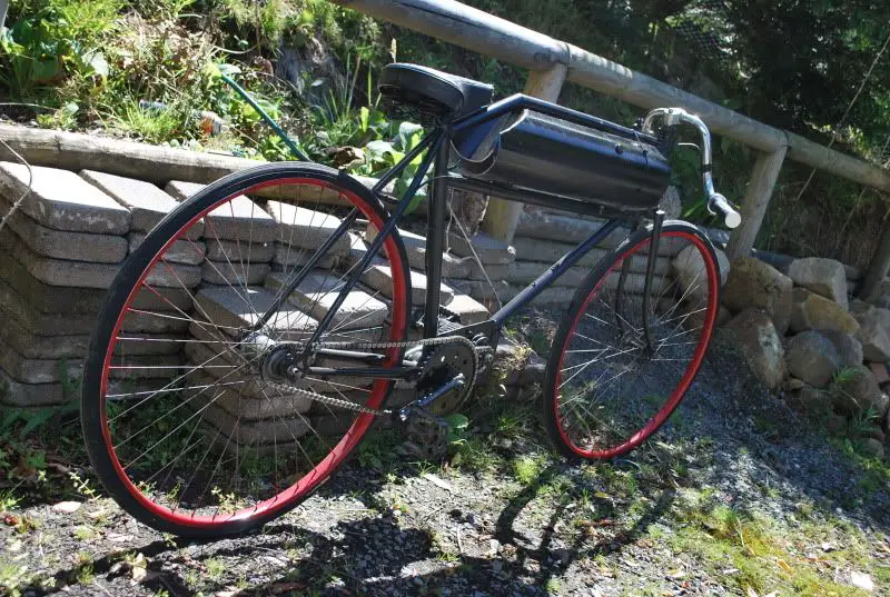

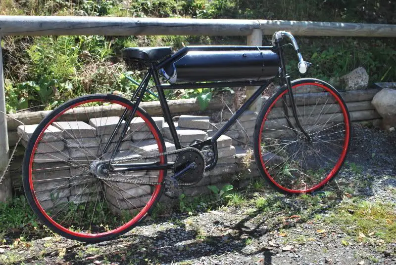

Hi there,
this was a project that I thought I'd never really finish, but only 3 months later it is DONE!
it was an experiment to try these 24V geared brushed motors on a chain drive setup with a hand made freewheel crank, and it works with great success..
not a daily commuter, but a great head turning bike for fun riding!!
its currently for sale on ebay.com.au item number 170452873869, no reserve!
