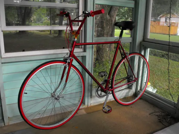

Here's the bike you may have seen: a Schwinn World Traveller I bought from a junk man for $5 and rebuilt. The frame is lugged, but the tubing is a little bit heavier than an actual racing bike. These were made in the late 70's or early 80's I think. I'm putting a slant 48 on, to keep the weight and noise down, and because I am a little bit concerned about the strength. (I could switch later, but my cruiser already goes faster than I want to.) The new kit does not have an intake and looks like the newer carb that's just out- at least it has the white shutoff valve like it- so I think it will run pretty good. I've replaced the original steel rims with alloy- and that has dropped the weight to not much more than a racing 10 speed of that era..
I've got a chrome tank for it and an extended chrome muffler which looks great and should be extra quiet. The front derailleur will come off, and I haven't decided about the back one yet. I may usea single freewheel. The brake levers will again be combined into a dual lever which works great, and the center pull Dia Comps are excellent strong brakes. I havean extra-light 34 sprocket and so i'm hoping the final weight before fuel will be about 37 lbs.

that would be sweet ride Nashville Kat...the red road bike but as the earlier people said would it be realy uncomfortable???

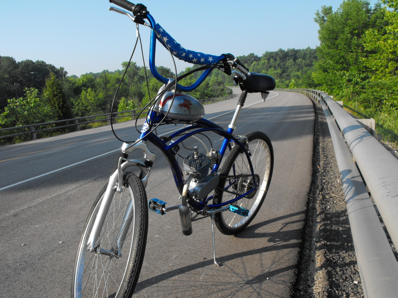

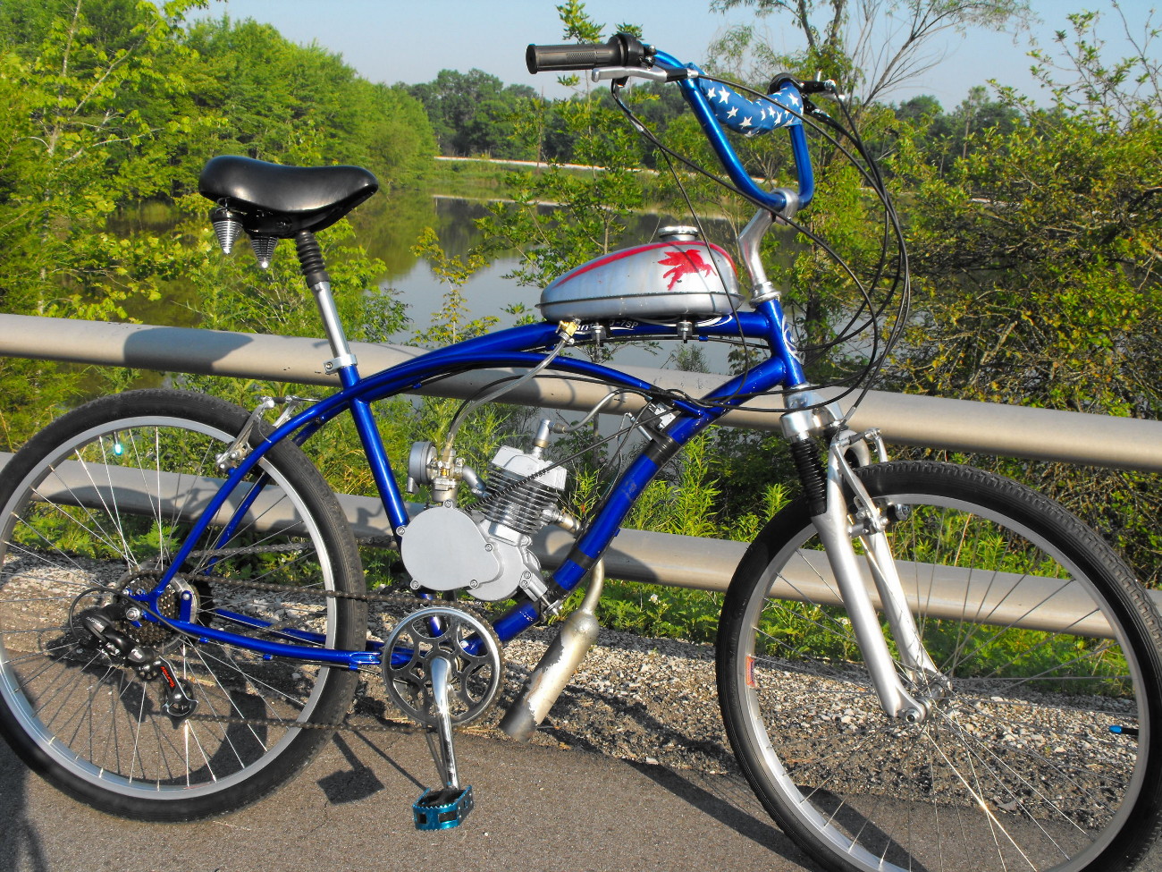

The suspension seat post will help I'm sure. I also put that suspension fork on the cruiser which really makes a smooth ride, but I don't think I'll do that to the Schwinn- they really add some weight.
No, in fact there's no reason why it should be uncomfortable. It's strictly for the road- I thought about putting some flip/flop 700C wheels with even skinnier tires, but decided that was in fact too minimal- the 27 x 1 1/4 is really quite a lot of rubber compared to the tubular sew-ups I rode racing, and the big wheels smooth over bumps more than smaller 26 wheels.
In fact the cruiser photos from last summer are now dated. I put a 27 x 1 1/4 wheel on the front of that too, with alloy rim and a blue tire, and it rolls even better! And I've also now got the dual brake lever on the bars.
But as for the red Schwinn, it IS responsive and the wheelbase is short compared to a cruiser. But with just a 50cc motor, I'm hoping it will give a nice roll, without as much noise or vibration as a 66.
