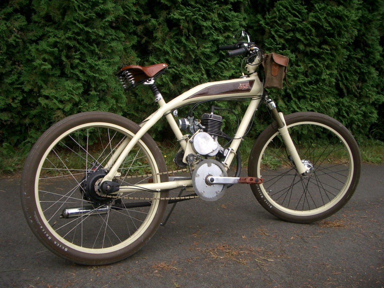

You know fair, there is a member here that sealed the top tube on a sweet lookin' felt bike, jackshafted, kinda off-white in color. The person that did that bike also did a thread I believe on how they sealed the top tube and turned it into a gas tank.
I forgot the persons user name but I do have a pic of the bike.

Clotho... I love that bike. I am searching now.
Thank You NunyaBidness
