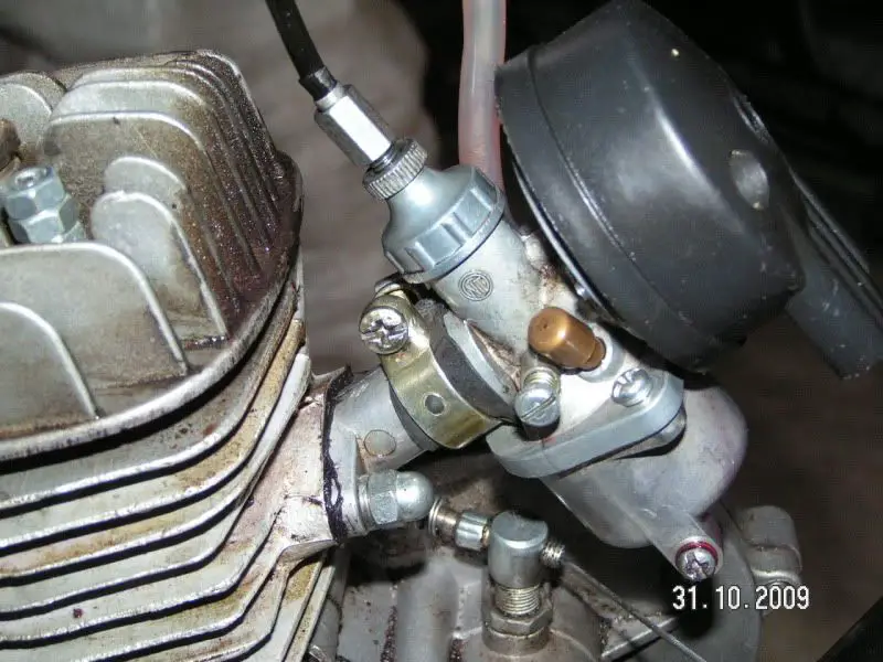

I had a problem running my carb at an angle far less extreme than yours, and the discoloration on your head looks like a sign of a massive leak... but it's a touch odd because it's usually from the head gasket so that "stain" would be lower - perhaps yer leaking from around the spark plug and/or headbolts?
The thing on the carb is usually referred to as a "primer" - sometimes even a "tickler" BTW and don't worry about air leaking there - that wont effect anything, but it combined with the radical angle of yer carb probably IS causing the puddle on the floor
4 stroking is usually a sign of runnin' rich, but I'd blame a combo of tilted carb and air leaks causin' yer heartache - at least from that pic anyway...

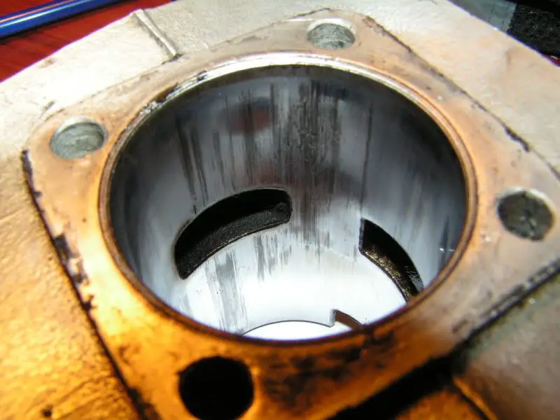

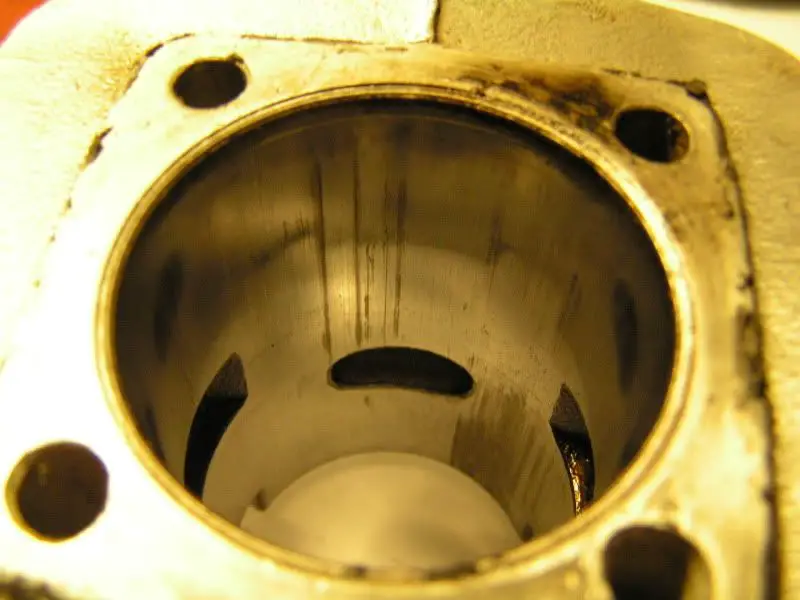

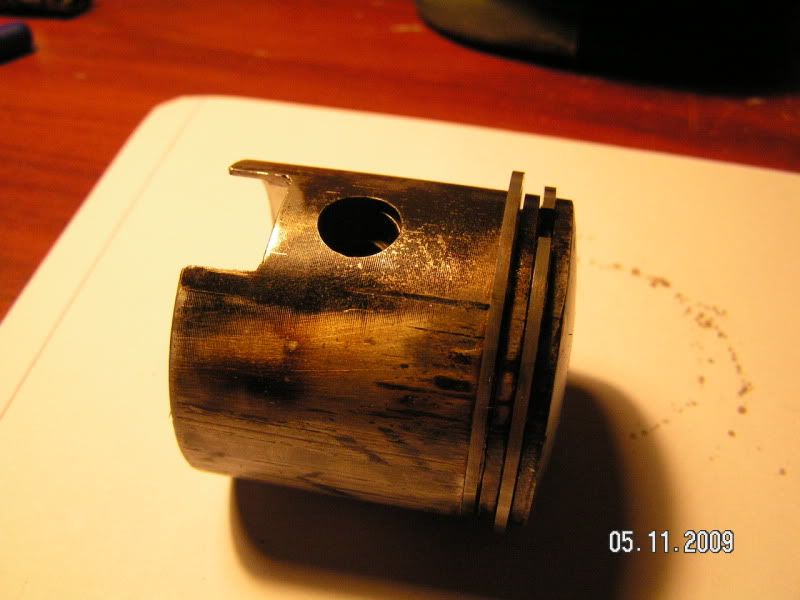

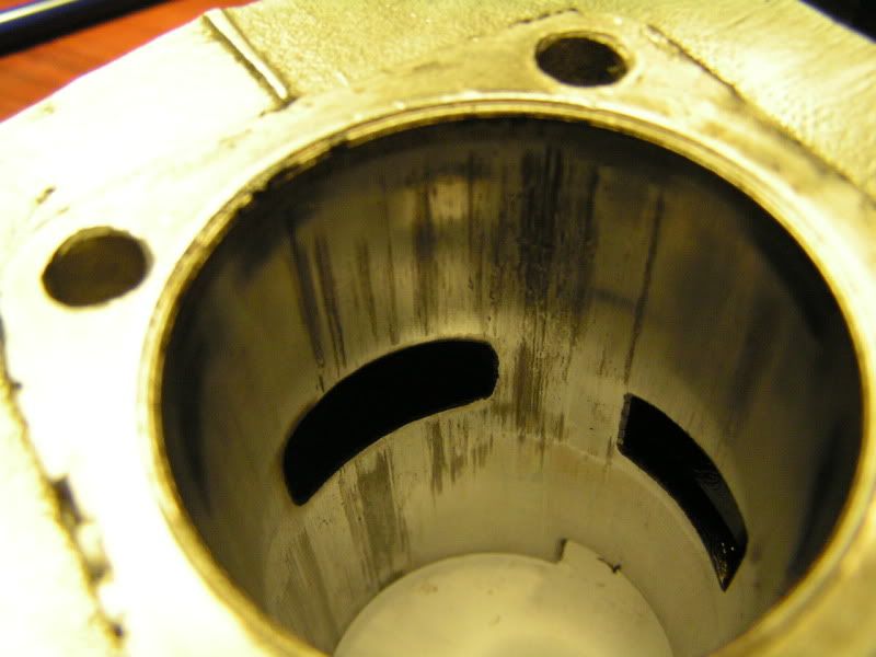

See this pictures:
You can say that the piston and cylinder are in bad conditions, but i remember that before i opened the motor, the bike was running relatevely good, so i think that brown and dark marks are not a "big" problem..
4.45cm of diameter, and 4.8cm of height - piston
What you think about piston rings? and the head?

looks like they're toasted. the dark carbon deposits on the top of the piston are normal. but the sides and the inside of the cylinder itself should be nice and shiny clean.
looks like your cylinder walls are scratched and scored. this is allowing the burnt fuel to blow past the rings, creating those brown, scorched marks.
that's not good.
did you say you put in new piston rings? they're probably the wrong size.
and when you said you "polished" the piston walls, what did you use? did you leave any abrasive residue in there? did you scratch or gouge them while re-assembling?
looks like you're gonna need a new motor.
and your carb is on way too harsh of an angle. it should be as level as possible, and the way yours is, it's like pouring the fuel out of the float bowl into the motor.

also, that last picture of your cylinder wall, that dark spot in the upper right hand corner looks like a head gasket leak, and it looks like there's a chip in the block right there.
also, not good.
