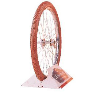

there's a few china companies that make the same tread styles as vintage bicycle tires, chengshin and uh... i can't think of the one that makes the old schwinn typhoon tires, they're uh... grand tycoon, i think.
you can still find NOS vintage tires on auction sites, but a lot of those are already dry-rotting, and i wouldn't trust them to go fast.
coker tires have some real vintage ones now and then. i dunno if they go into limited production, or if they just keep pulling them out of their...warehouse, but they keep showing up every once and a while. like these: B.F.GOODRICH BICYCLE RED - Coker Tire
there's also a guy on that big auction site that has blackwall BFG's for 20 bucks a piece.
26 X 1.75 VINTAGE BF GOODRICH BICYCLE TIRES - eBay (item 310144899123 end time Nov-22-09 11:44:52 PST)
