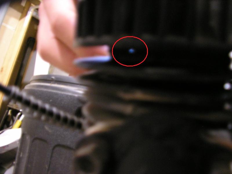

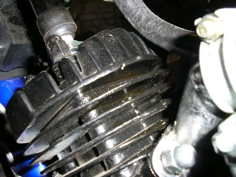

So I figured it out. I don't have any idea how I missed it, but my head gasket is leaking pretty badly. I saw the oil all over the cooling fins, but I had a gas line leak recently and I figured the oil was left over from that. Anyway, it's not just that, it looks like the cylinder head is warped. You can actually see it, I've included some pics. In the second one that you can see light from my flashlight coming through between the gasket and the head. I know it's blurry, but it was a hard pic to take.
So Now I have a few questions. For one, what would cause this to happen? could have always been warped, but the gasket held it back from leaking up until recently? Did I over heat the engine? Are these cheap china engines always like that? Also, I went ahead and ordered a new head and gasket, but I couldn't find a head that was rounded and black like the original one. Anyone know where to get one like that?

I took the head off and it is actually not warped. The casting has a curve to it that made it look warped, but the surface that is in contact with the head gasket is machined flat. So what I have here is a run of the mill blown head gasket.
