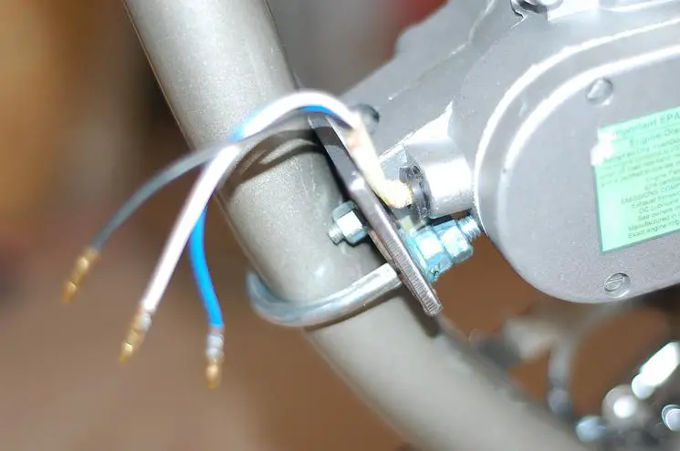

I am using a muffler clamp, bushing from a bike axil and a bolt and nut. You can get the stuff at any automotive parts place, or hardware store. I welded the bushing to the clamp so the hole is in the same direction as would be the mufler pipe. The bolt goes through that being held in place with the nut. The clamp is put around the down tube above where the motor sits. Tighten the bolt till it pushes the motor down. the rear mount must be in place once tight tighten the rear mount. This will work even with the front mount broken.

What I did was use a muffler clamp, bolt,two nuts, and a spacer/bushing from a rearbike axil. utf-8BSU1HMDA3MTYuanBn.jpg picture by 247jude - Photobucket, utf-8BSU1HMDA3MTUuanBn.jpg picture by 247jude - Photobucket,
utf-8BSU1HMDA3MTguanBn.jpg picture by 247jude - Photobucket,
utf-8BSU1HMDA3MTQuanBn.jpg picture by 247jude - Photobucket
Jude
