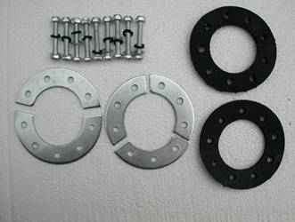

Noob here..Alright so The directions the came w/ the kit are like useless.
I cant figure out how to install the rear sprocket.
For those who have beach cruiser(cranbrook walmart bike) help me out.
Im this far: I took off the coaster break arm+dust cap. but I dont know where the 2 steel plates go (in picture)?
I kinda have an idea on how its supposed to go together but if someone could let me know how It all goes together including the coaster break arm it would help me out so much.

Listed from the outside of the wheel, going towards the center of the hub.
1. sprocket.
2. rubber ring.
3. spokes.
4. rubber ring (you will have to slit it once to fish it behind the spokes).
5. steel half moon looking parts, only one layer thick. (Some kits come with enough to do 2 wheels. I don't know why.)
6. nuts.
Darn it all, I wish I had a picture to show it!
