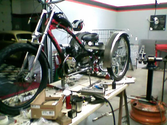

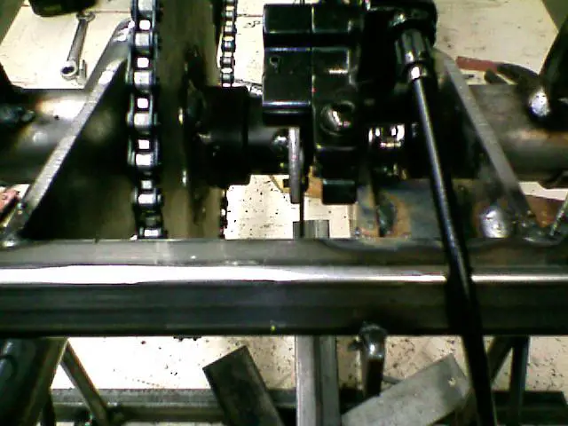

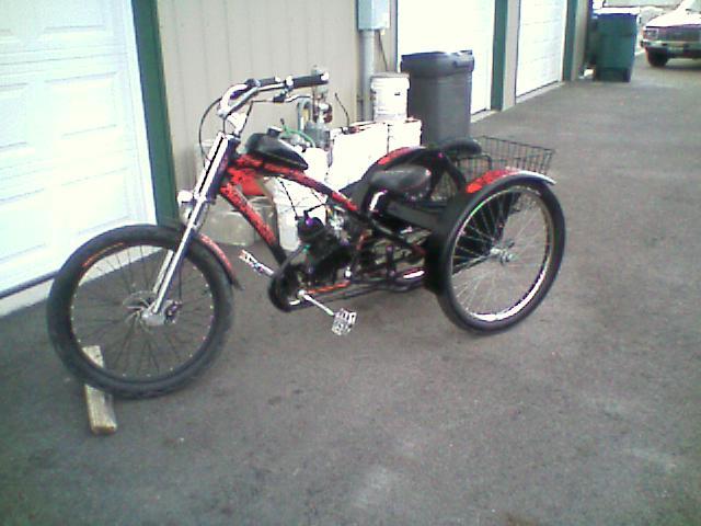

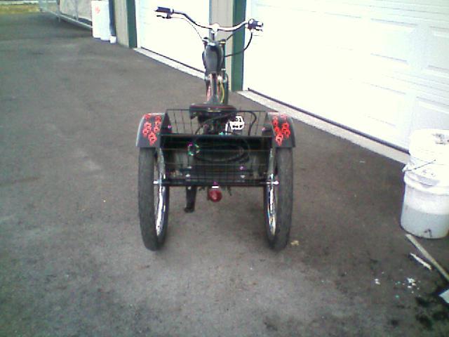

I built this out of a west coast chopper made rear out of 3/16 plate and dom tubing 3/4 axle shaft, hand built fenders. front and rear disc, hand built exhaust
