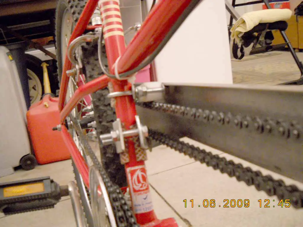

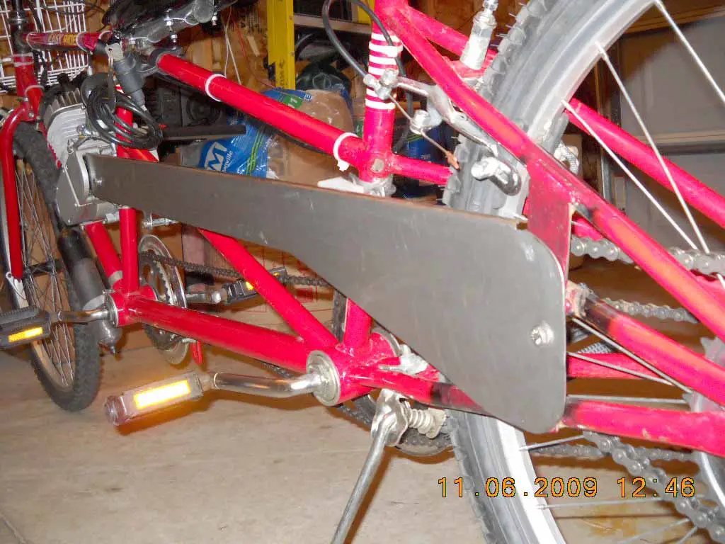

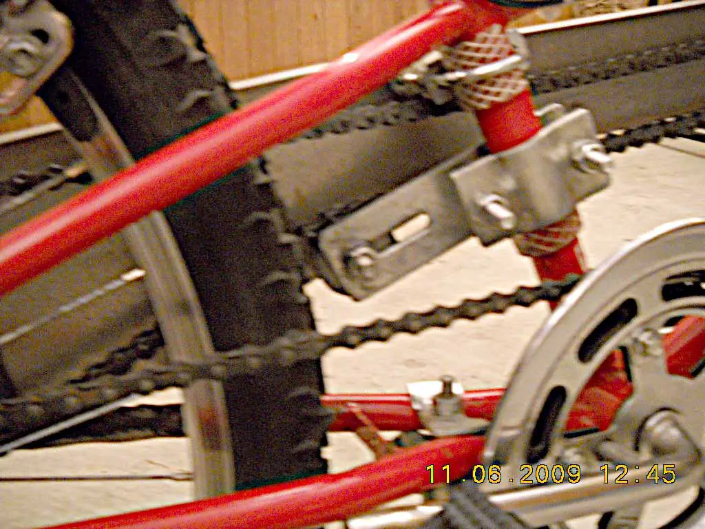

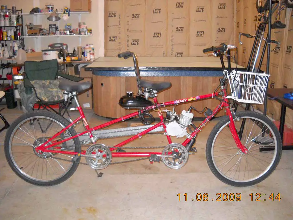

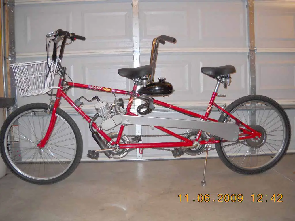

Regarding some questions on my tandem. It was a straight forward install. Performance was with no pedaling, and my chain set up will be clear via attached pix with what I added (3/4 whole xtra chain.
I cut the mid LH support out, cut 1/2 of lower support out & filled w/steel for support and a vert piece you see in pix for add'l support. Now chain clears frame fine retaining stregnth. Paint this Feb.
Getting almost too cold now to bike here in Michigan. Frost on the ol' seat post.
Somewhere I posted other pix but here are some again for ya.

That is way cool looking setup just curious why the backwards tank? You must have access to sheet metal shop that just looks like a pro install! Line that thing with pannier bags and you could do all your grocery shoppin on that.
