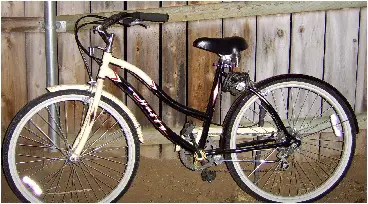

Hello All,
My name is Michelle and i recently ordered a engine kit that i would love to install on my Women's Beach Cruiser. I have attached a pic of my bike below. I am looking for any help i can get on how to mount my new engine to my bike. Everything i can find online just shows how to install the engine on a mens bike and everyone here seems so helpfull, i would appreciate any tips or instructions i can get.
Thanks

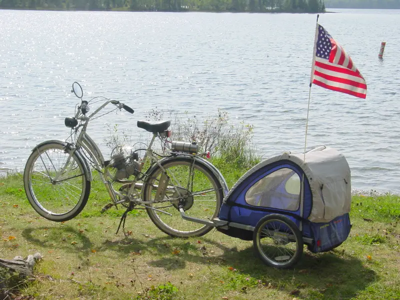

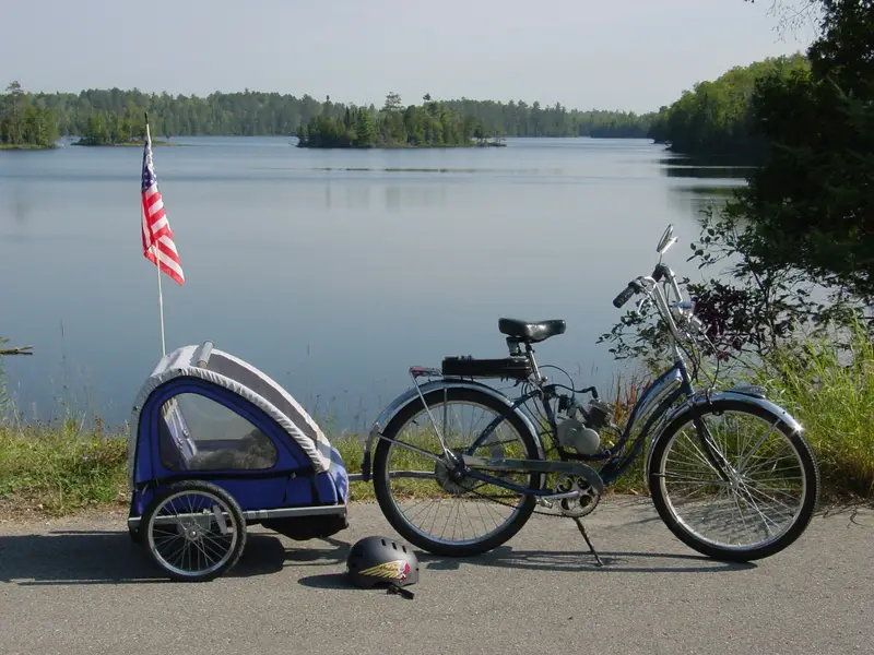

Spookytooth has a good reputation. Has the kit arrived yet? One thing you may need to get is a rear rack so you have a place to mount the gas tank. Here are a couple pictures of 63 Schwinns with HT motors.
SB

Gearrnut presents another gas tank mounting option. It is the only one I have seen mounting a peanut tank that way.
Regarding a rear rack, there are different kinds of rear racks. Take a look on ebay and you can see. I guess in part it is a matter of what your intentions are with the bike. If it is to be functional only, then any kind of rack will probably work if it is for your size bike. A 26" bike needs a rack designed for a 26" bike. The supports which attach at the wheel area need to be of the right length. You might find a used one at a bike repair shop, or online. If you have a particular look in mind then you will need to do some searching. Reproductions are made which look much like the one on the back of Gearnut's Hawthorne and look like some the old Schwinn's had.
In the pictures of my Schwinn Americans two different gas tanks are shown. The low dark one can be purchased from That's Dax and the cylindrical one is from an old lawn mower. I have also seen peanut tanks mounted on the rear rack. One nice thing about doing something yourself is that if you don't like it you can change it later.
