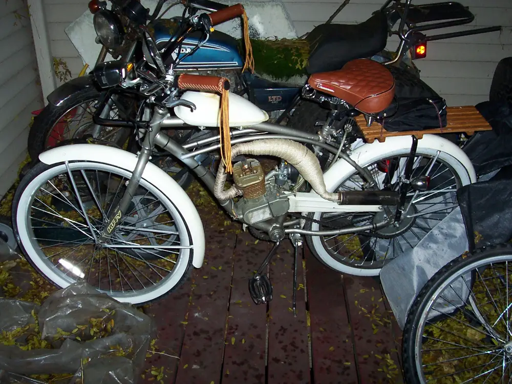

That's what mine is, well that's what mine started out as.
Replaced:
Fenders, off an old Schwinn
Rear wheel, heavy duty 12 gauge spoke coaster brake. Check and GREASE the bearings like posted above!
Seat, $40 investment adds WAY more comfort.
