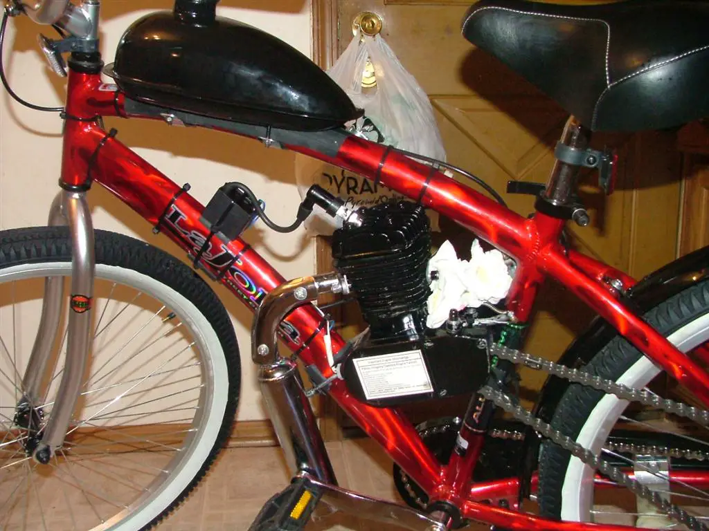

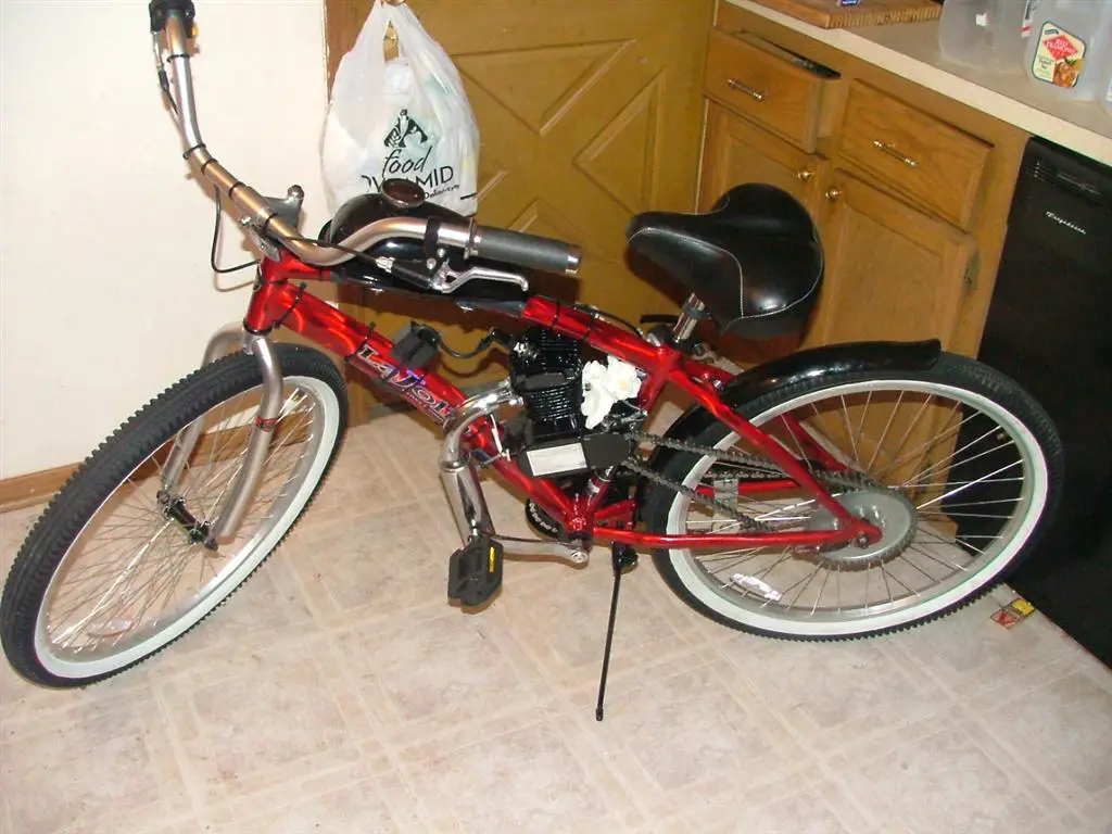

Pic #1 a loose fit of the Motor after We got the sprocket on and the wheel trued. All the little things are there too!

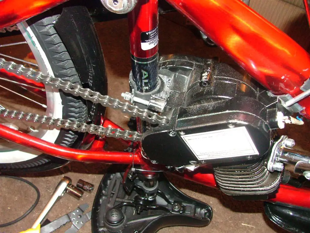

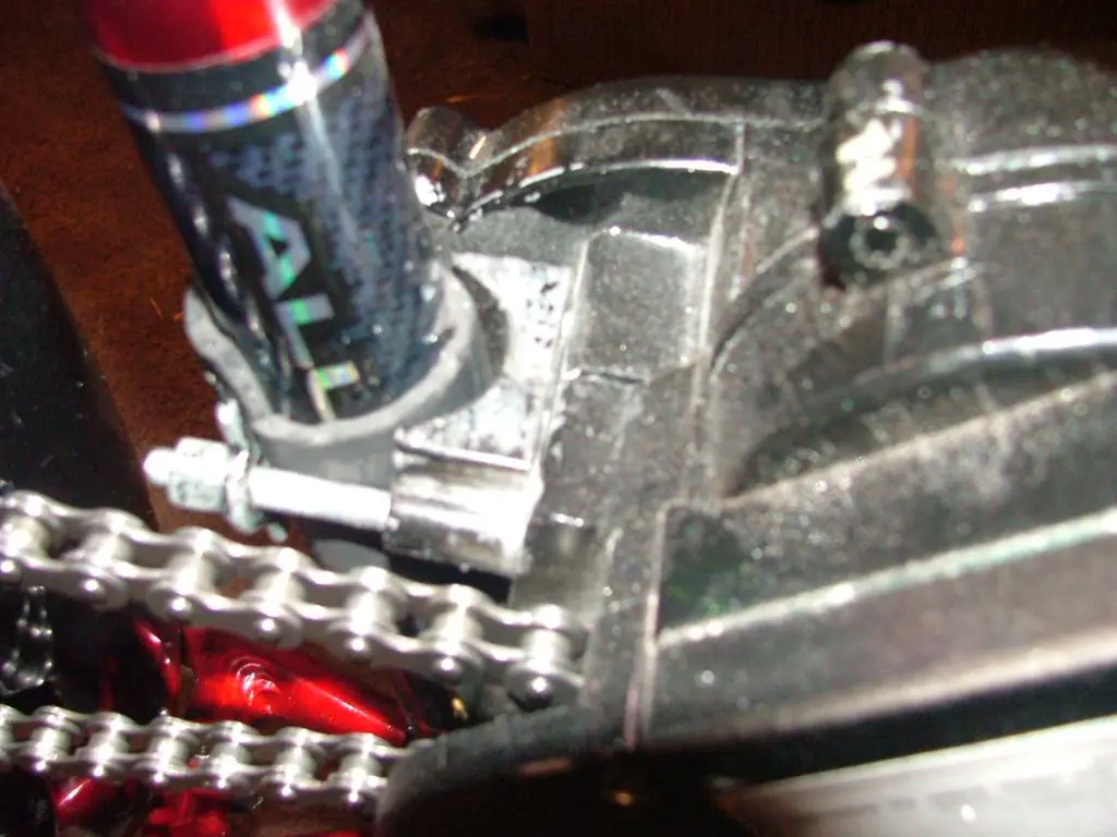

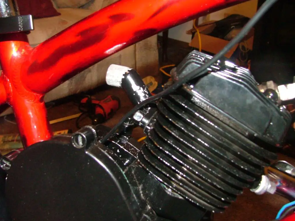

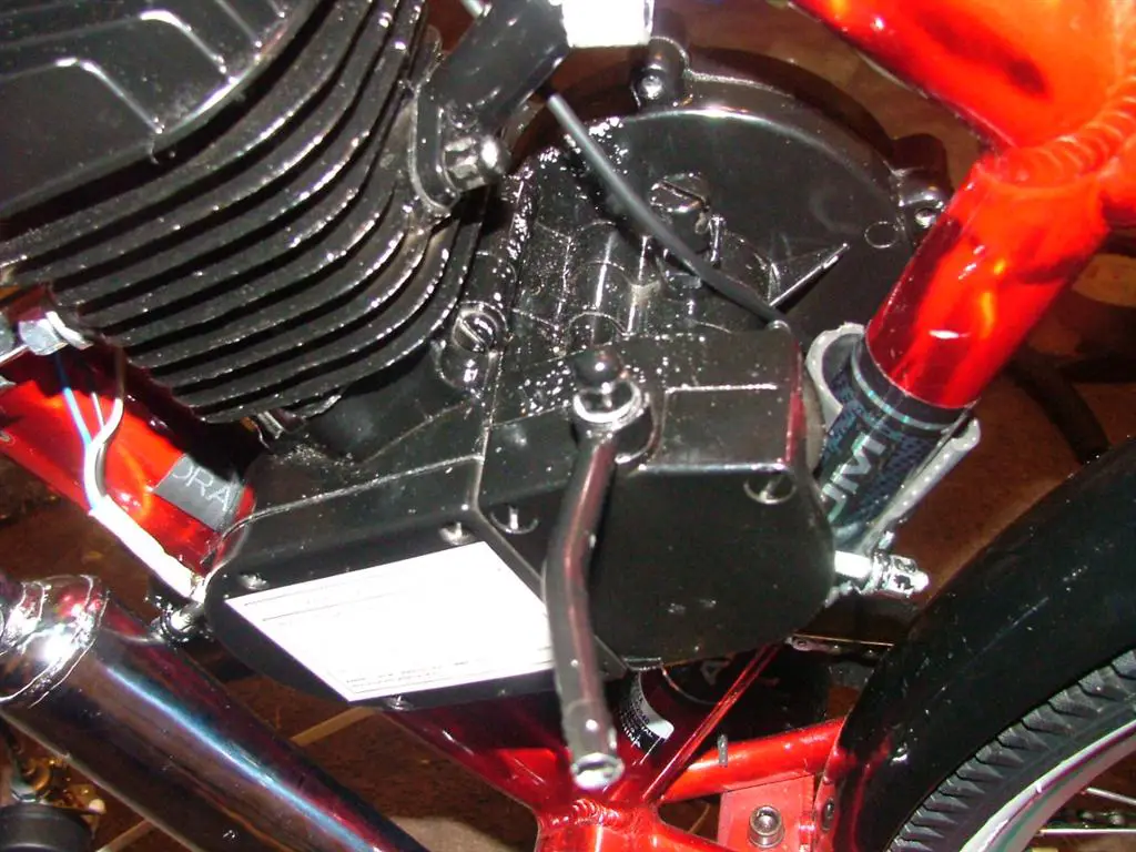

Pic #2 & #3 are of the Modified Engine Mount, I did pull off about a 1/2" and It gave me more clearance.

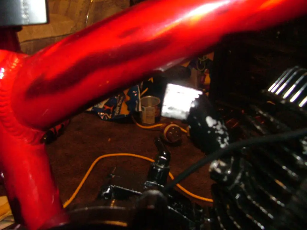

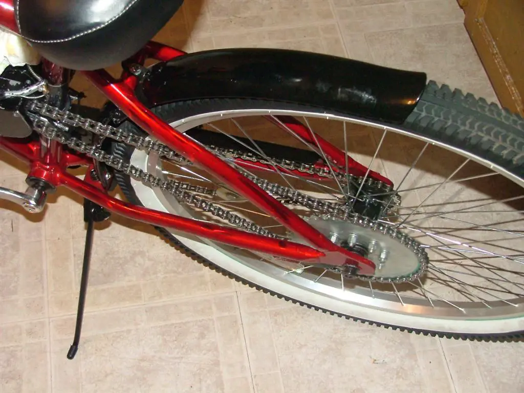

Pic #4 & #5 Are of the little bit of clearance I had with my frame and the intake.... I sanded it so melted paint wouldn't get into the motor..... Well I don't need it anymore lol....

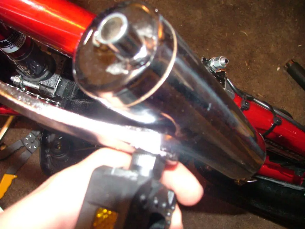

Pic #3 The Clearance of the muffler and pedal cranke is sub 1/8" lmao, I really think It'll be ok but if not I can do something different.

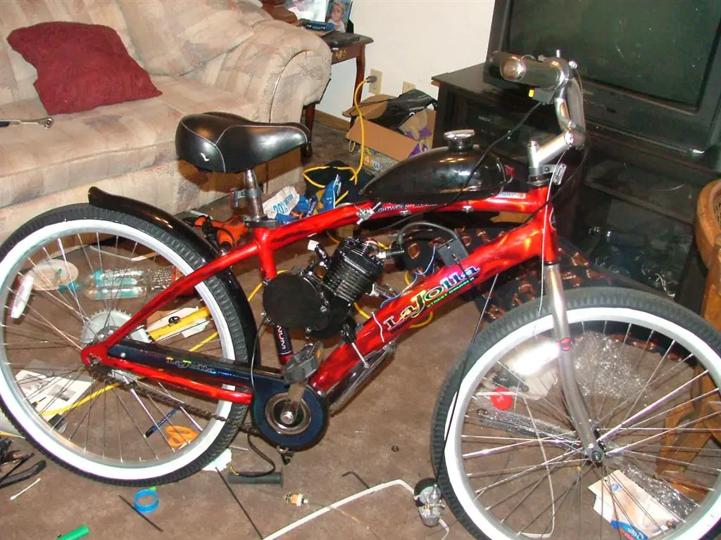

Pic #4 & #5 Are the finished Product Minus the Intake, Which I am still waiting on lmao.... I should have the piece sometime this week and I will be finished and ready to ride this weekend if all goes well!

I would get rid of that rubber you have in the mounts... It will cause problems down the line.
Also, you can 'slot' the mounting holes in the pipe & turn it out of the way of the pedals!
Good luck!
