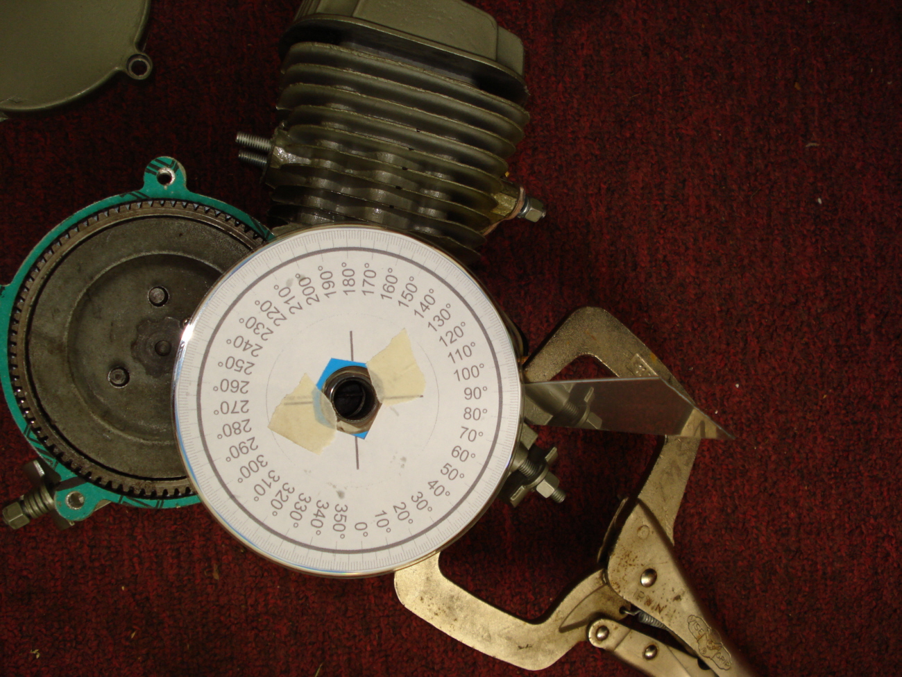

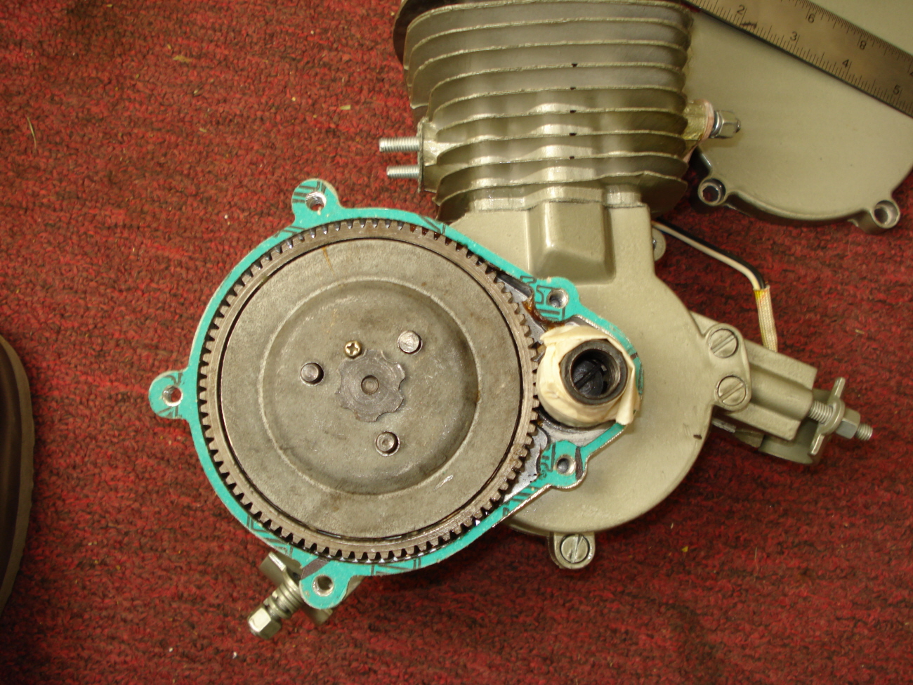

Had a little time this morning and got my timing numbers for the expansion chamber design software. the first picture is the gear puller with the bolt out attached with masking tape to the gear.
Works really good, the puller has a lip that fits almost perfectly inside the CD degree wheel I made up 2nd pic. Here is a link for a wonderful explanation on getting the numbers for both exhaust and transfer RC FAQ: How do I measure the port timing on my engine? , and a link for the right sized degree wheel picture to stick on that junk CD. How to determine the timing of your engine
I repetitively came up with 142 Exhaust and 114 intake 116 transfer had to pop off the head to get acurate measurement on the transfer. Now im off to measure an exhaust port area.

i think your numbers may be a little off, i got somewhere between 172 and 178 on the exh before i did any port work. thats why i don't raise the port very much. but then again, these motors are completely different than the next one on the assembly line. did you line up zero with bdc and not tdc, then note where the port is closed and double it?

Thanks for the info FourEasy.... what I did was zero my wheel as the exhaust just opens on the downstroke...and read as it just closed on its way back up. I will definately give the book a read and see if my numbers differ using the books method.

You need a degree wheel to measure the event timing.
What I found was the best method for event timing is to remove the head and use a piece of paper in the port.
Rotate the crank with the degree wheel on until the paper is only just trapped by the piston and the roof of the port.
Set that point on the degree wheel as zero.
Then rotate the opposite direction until the paper is again trapped and read the degrees.
Write down that number as the port duration - no fancy maths needed...
