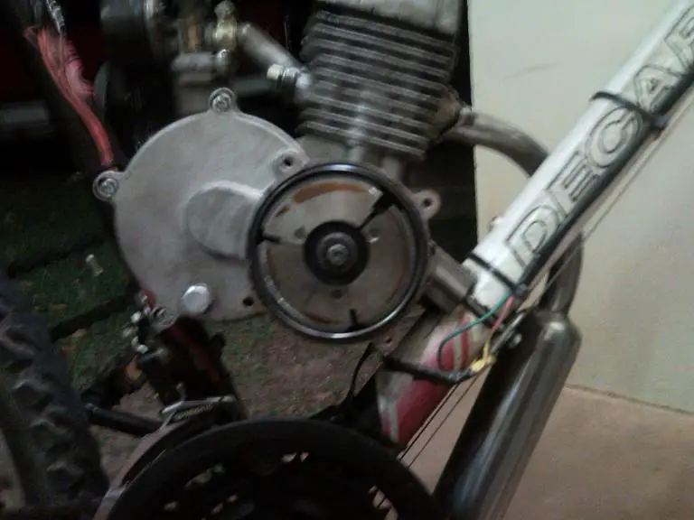

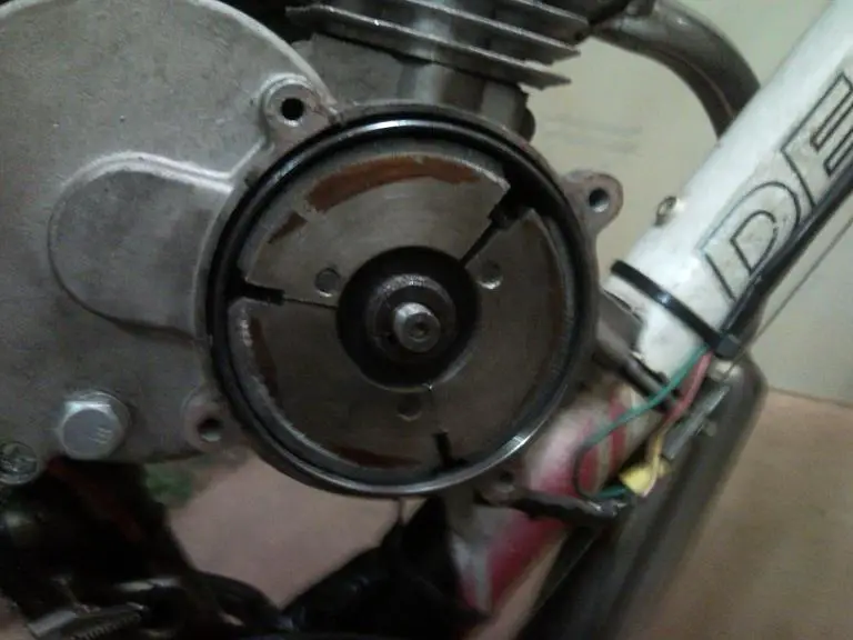

Hi Guys,
Does anyone know how to pull a centrifugal clutch out?
I have taken off the cover and the retaining nut...
Any help would be much appreciated.
Thanks
Joe

It's Ok... I got that sucker out
Regards
Joe

How did you get it out? I want to pull mine out to check the one-way spring.

You should have gotten a clutch-pulling tool with your kit.
You remove the bolt holding the centrifugal clutch to the crankshaft, and then the tool threads into the CF and the end of the tool pushes against the crankshaft, and the cf pops right off.
