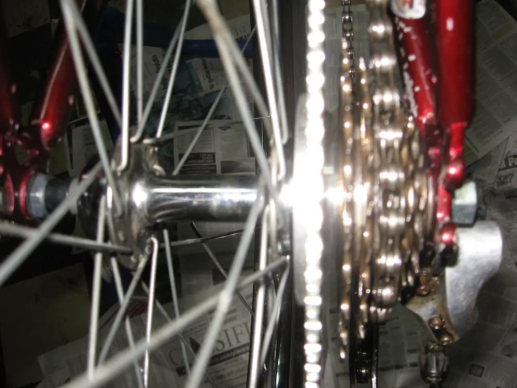

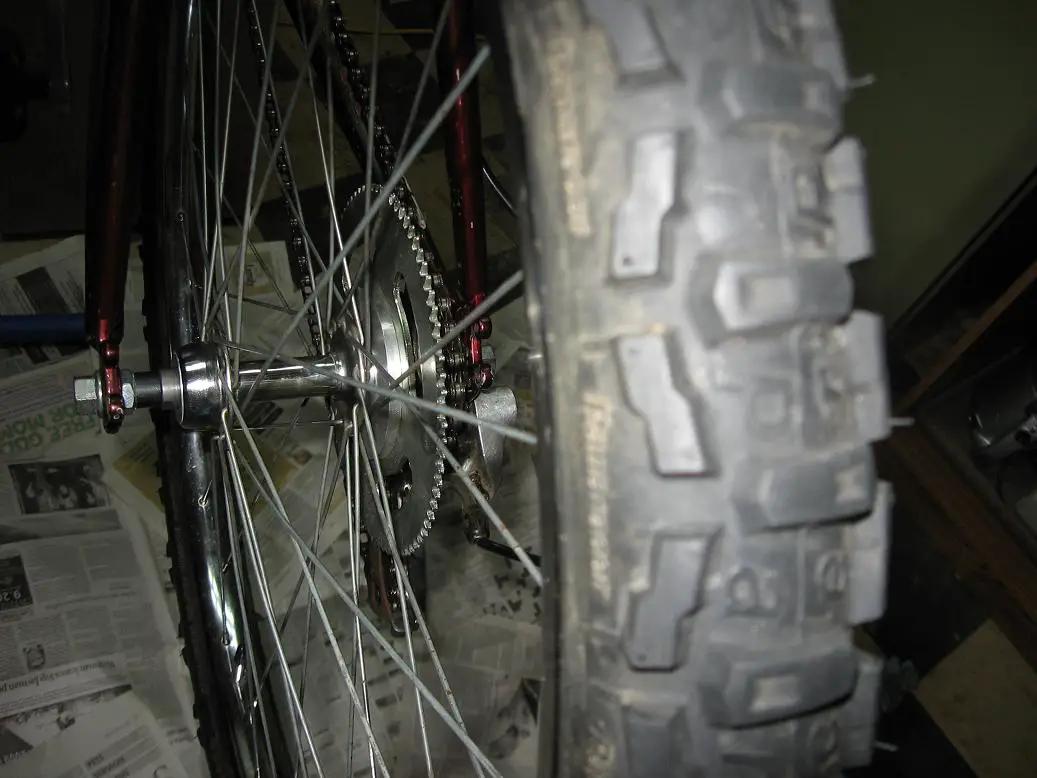

Old rusty wheel I found but just what I needed -steel rim and threaded hub.The axle was bent-could not use-sprocket cassette rusty and all gummed up.The wheel bearings after cleaned and inspected found to be O K. I soaked sprocket cassette in varsol then relubed-removed most of the rust from rim with scouring pad and penetrating oil. I assembled with new axle-cut down wide spacer to get7/8" on left side.
There is a plate that threads on to the hub.Then sprocket bolted to the plate. Then free wheel cassette bike sprockets thread on to plate, and that's how with my system I get free wheel on same side. Here are pics of bashed up rusty thing I'm gonna use for winter wheel on my winter bike. P.S. Have to re-center the axle.

Is that the reason for having a winter wheel, to protect your other seasons wheel from road salt and such? Or is the tire different. Sure doesn't look rusty in the photos. Nice job.

[QUOTE=silverbear;120306]Is that the reason for having a winter wheel, to protect your other seasons wheel from road salt and such? Or is the tire different. Sure doesn't look rusty in the photos. Nice job. Thanks Siverbear, yes that is the reason when it s frozen cold its o.k. but on the warm days, any bit of snow on there will melt and the little water droplets cause rust on the rim and sometimes when I neglect to wipe it down after a ride, the next day the surface rust is horrible-if not rectified quickly,it will eat right through the chrome. Where I live,very little salt is used on the raods-it;s moast of all sand.
