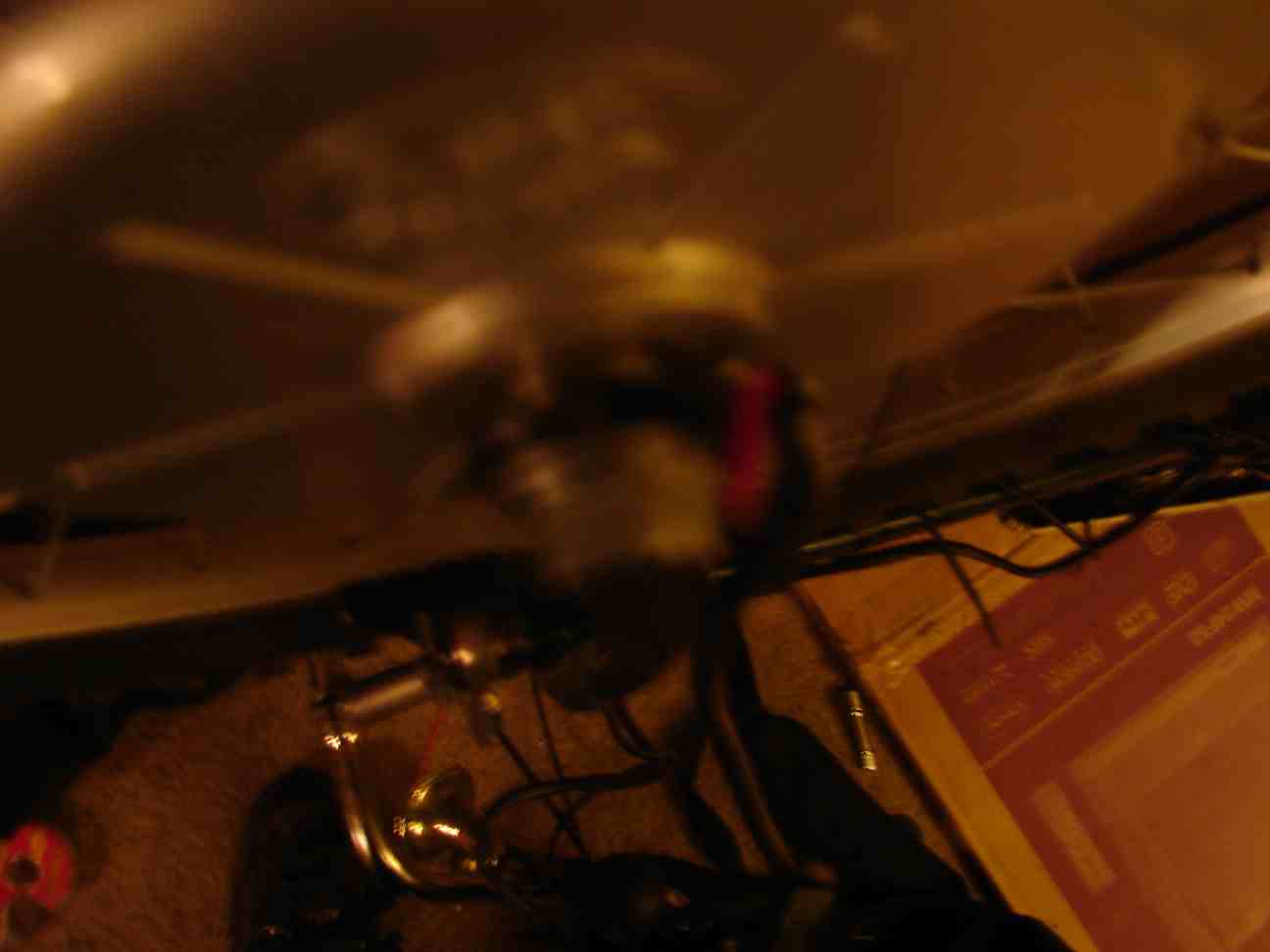

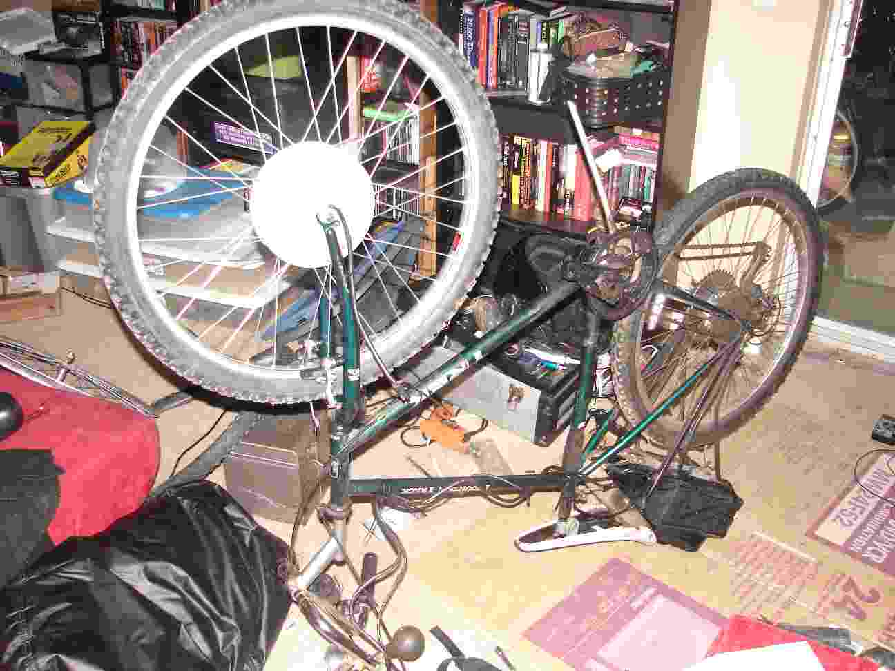

Last wensday i received a a Wilderness energy electric front hub kit to replace my long line of burnt 2 stroke engines. Well after a few moments getting trying it on a few of my frames unsuccessfull due to front fork clearances i finally decided to strip the junky 50cc borrowed from my brother of my main rides frame and setup everything. Well one thing led to another and i believe and i am hopeing its either a carbon brush or a simple lead issue goint to the axel.
enclosed are some pictures i hope they explain a little more then what i am capable of writing.
the axel shot looks like the + red wire got riped out of the axel or something.

So I tried to take the motor apart in order to resolder the power leads that got torn off, after about 8 torx bolts, one spindle nut and about a hour of trying to manually remove the cover i ended up deciding to search the net concerning hub motor disassembly. The two guides i found one for brushed and the other for brushless systems i've come to a conclusion i am going to have to get a flywheel removal tool you know those scary looking things with three claws that clamp around your flywheel with a central screw pillar thing that kinda reminds me of either a head crab from halflife or the alien larval head hugger but robotic style.

well good luck to you.if you have two wires you most likely have a brush motor. The brushless usually has five wires. However that may or may not be an absolute. I just don't know much about them.

in answer to the hub motor that you cant seem to make go. If it has three wires such as green blue yellow its a three phase or brushless type. if it only had two wires such as green yellow or red black it has brushes inside and it is an old one. the wilderness energy people got ganked by china and lost a fortune in bad hub this year the newer three wire type is great if a wire rips out of the hub its toast
only the 2009 hub motors are any good or you can buy a Sparrow from electric rider in topika kansas they have a closeout at about 70 bucks
