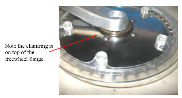

Default Re: “Black & Blue” My 2nd bike
Nice build, just an FYI on your Shift Kit installation. You have mounted your chainrings incorrectly. The large chainring should go outside of the freewheel flange. This increases the distance between the chainrings reducing the chance of the chains touching in the higher gears. Other than that, excellent looking bike. Love the tank.
Ghost0- can you post a picture or diagram of what it should be like? I haven't touched the bike for a while and with out it in front of me, I'm not sure mean. Thanks

I have attached a photo but to put it in words the two chainrings should go on either side of the mounting flange on the freewheel. So your stack up from outside to the center of the bike should go as follows. 44t chainring, freewheel flange, spacers, 36t chainring, nuts. Let me know if it is still unclear.
