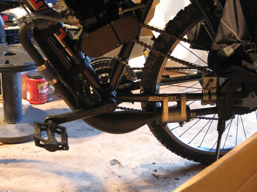

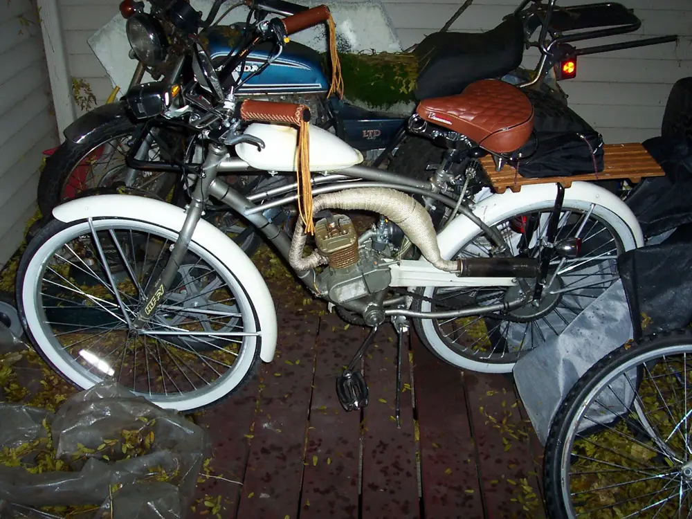

The kit supplied tubing has worked out well so far, prob with the aluminum tape is I figure the adhesive would cook off?
You could clamp over it I suppose... I unno, I don't like how the tubing looks - but I sure like how it works lol

Old 10-25-2009, 08:06 PM
Kevlarr's Avatar
Kevlarr Kevlarr is offline
Join Date: Jul 2009
Location: Mi
Posts: 1,630
Default Re: Tuned pipe exhaust leak ideas

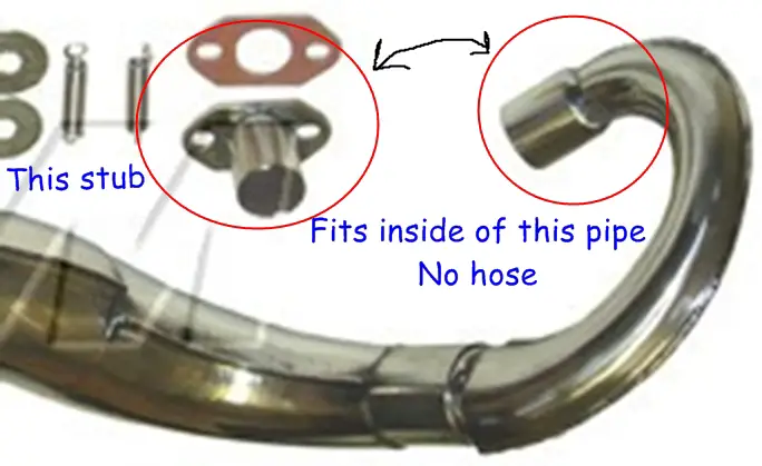

No not a SBP kit but I don't think theirs has a hose there either. This is a pocket bike pipe that I modded to fit my bike.

Old 10-25-2009, 08:08 PM
GearNut's Avatar
GearNut GearNut is online now
Join Date: Aug 2009
Location: San Diego, Kaliforgnia
Posts: 2,773
That looks like the stuff I am talking about. It's kinda hard to tell positively by looking at a picture on a computer though.
