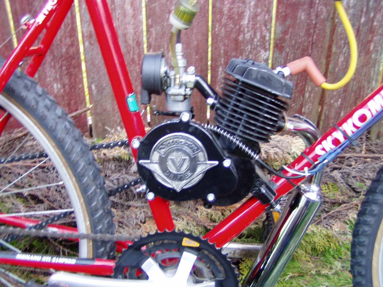

I did this to dampen the gear noise. I think it mostly stops the thin cover from viberating. It's a tank badge off my old motorcycle. I pounded it out flat with a rubber hammer and mounted it with dbl stick foam tape. If you fab up a long header pipe for the stock exhaust and mount the muffler on the rear stay it will be very quiet. The pic is old from my original build.
