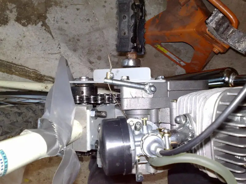

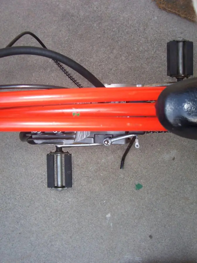

the bike should ride almost normal with the clutch pulled. if it's not rolling free at all, something's wrong.without the clutch working, you wouldn't be able to stop without it stalling, and it'd be a real problem trying to start it.
can you post a picture of the clutch arm and cable on your motor? sounds to me like it's just not adjusted properly. here's how mine looks...

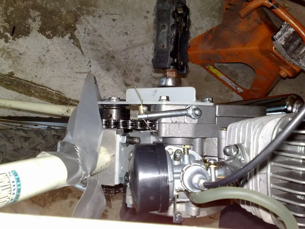

Here are some pictures of my clutch lever.
Clutch released:
Clutch actuated:
Also, here is a short video showing the clutch being actuated and released:
YouTube - Dax 2stroke clutch actuator
