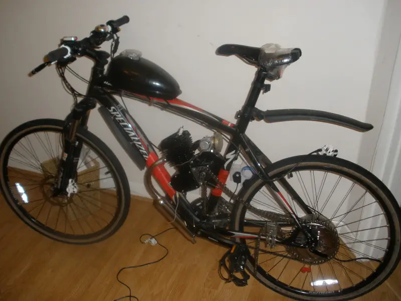

Story so far.

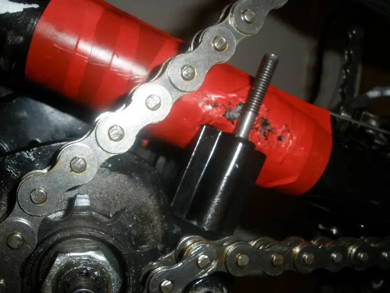

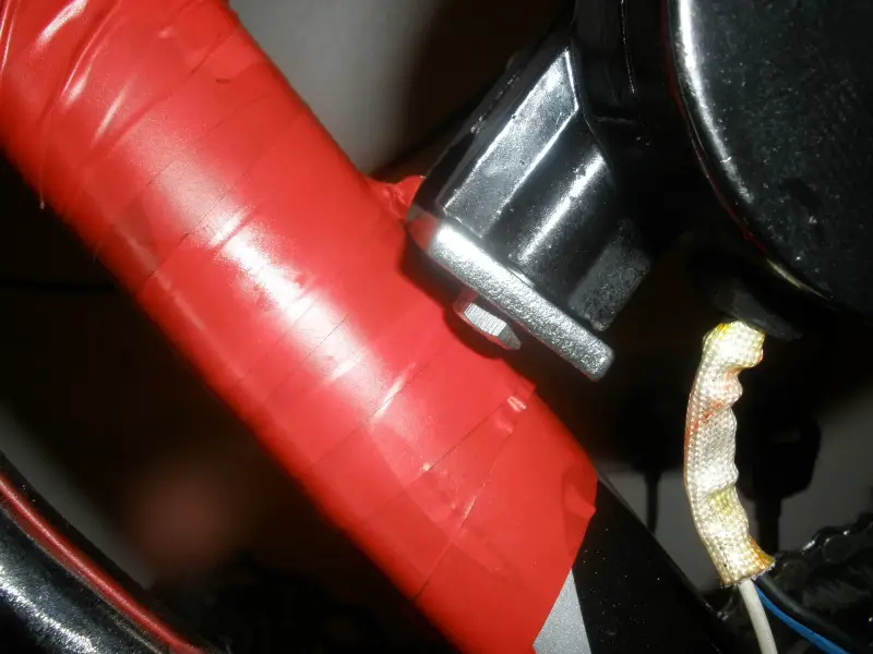

I have fitted 60cc kit into 19 inch frame, which has a weird shape.
Bottom mount is a bit skew, will post a pic when I can. Should I just bulk up with rubber mount or something?
Rear mount not quite a snug fit, bit straight, maybe use some rubber here too.

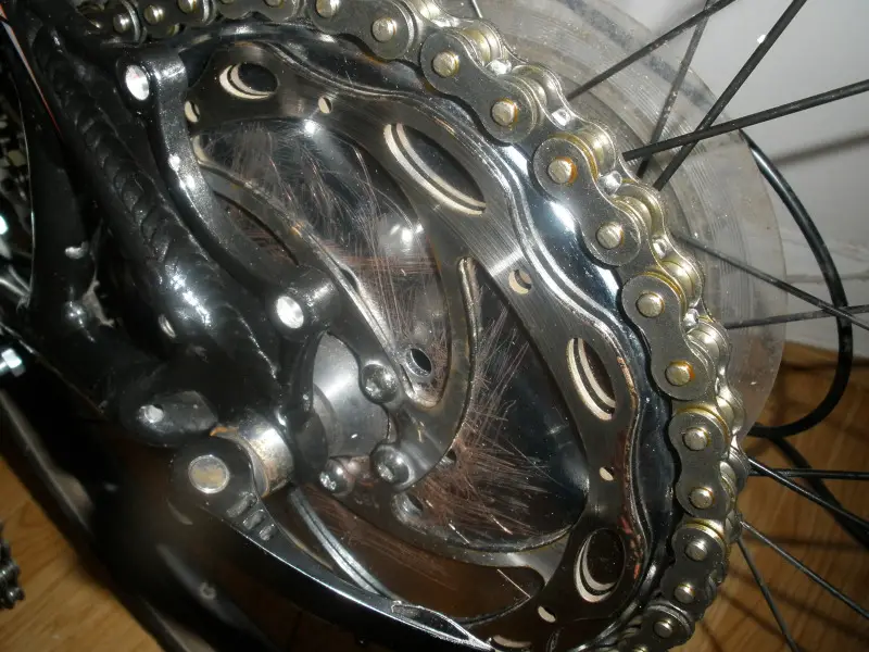

Homemade rear disc mount sprocket.
I drilled out using disc as a template on top of kit sprocket. Used disc over the top of sprocket for extra rigidity. Will buy a kings sales and service soon.

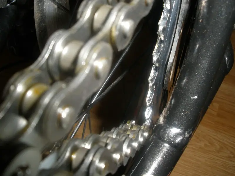

Chain is touching rear bars, any ideas?
Ed

Here are the pics of the parts mentioned above.
Any ideas.

Old 10-23-2009, 12:03 PM
pedro5189 pedro5189 is offline
Location: England
Posts: 81
Default Re: Specialized Hard Rock Pro 2009
kick the sprocket toward the wheel with a kings top hat adaptor, or if you have access to machines have one knocked up.
Old 10-23-2009, 12:35 PM
sweetlikealemon sweetlikealemon is offline
Join Date: Oct 2009
Location: UK
Posts: 11
Thanks, just placed an order for the Kings Sales and Service
1/4 inch offset Top Hat and 3/16 inch offset 34t sprocket.
Ed

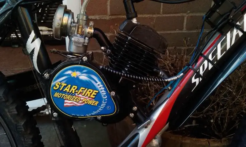

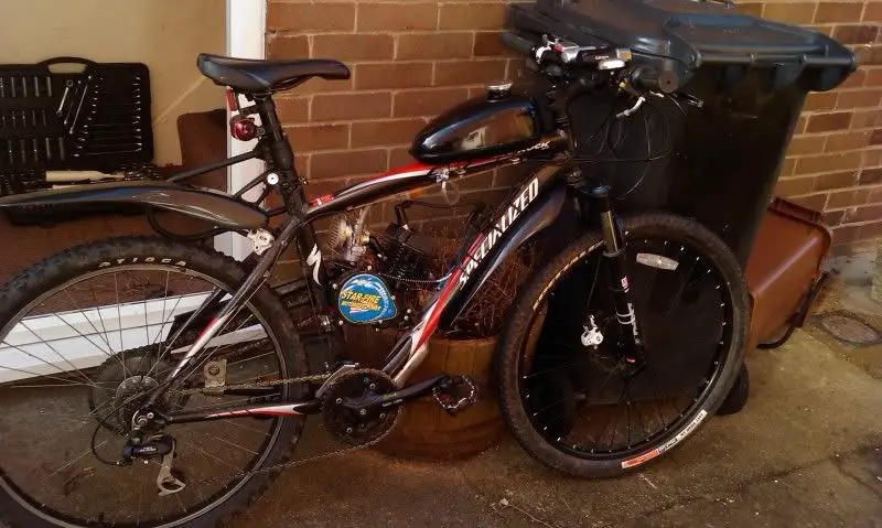

An updated pic of my Specialized with a 60cc. Been running for around 200 miles.
No issues, smiles every mile and of course "The Look" everywhere I go.
I am STILL waiting for Top Hat and New sprocket, so at the moment I have a non disc brake wheel and not running a rear brake
