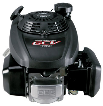

welcome to the forum it sounds like you already have a pretty good idea of where youre going but maybe if you could throw up some pictures of your motor somebody could point you in the right direction there are lots of guys here who DIY but unfortunately i'm not one of them but good luck and again welcome hey is this it i found this but i dont know if this is the same as yours GCV160

yes that is the engine just a new version the one i have looks like this

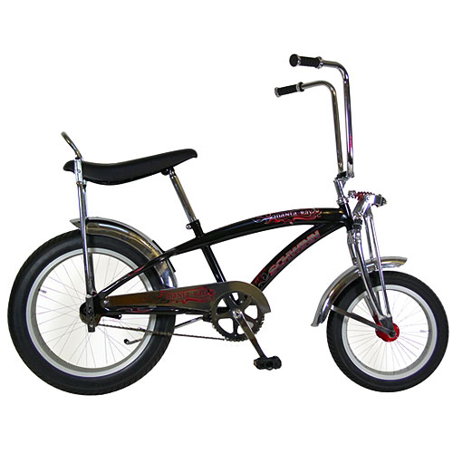

it is going to be mounted above the rear wheel the shaft will come down and a type of rubber piece will rub on the rim wall thus moving it, it will be securely mounted and the clutch will just pivot the engine so that the rubber piece no longer comes in contact with the rims sidewall i have heard people have gotten this to work the only error i may see is that the rubber piece may be able to slip a little against the side wall of the rim but i figure i have so much more power than i need i can always just hit the throttle a little harder and someday it might carry two people since it has excess power. thanks i hope i answered your questions any other input will be appreciated. oh and the bike kinda looks like this except i made some adjustments.
