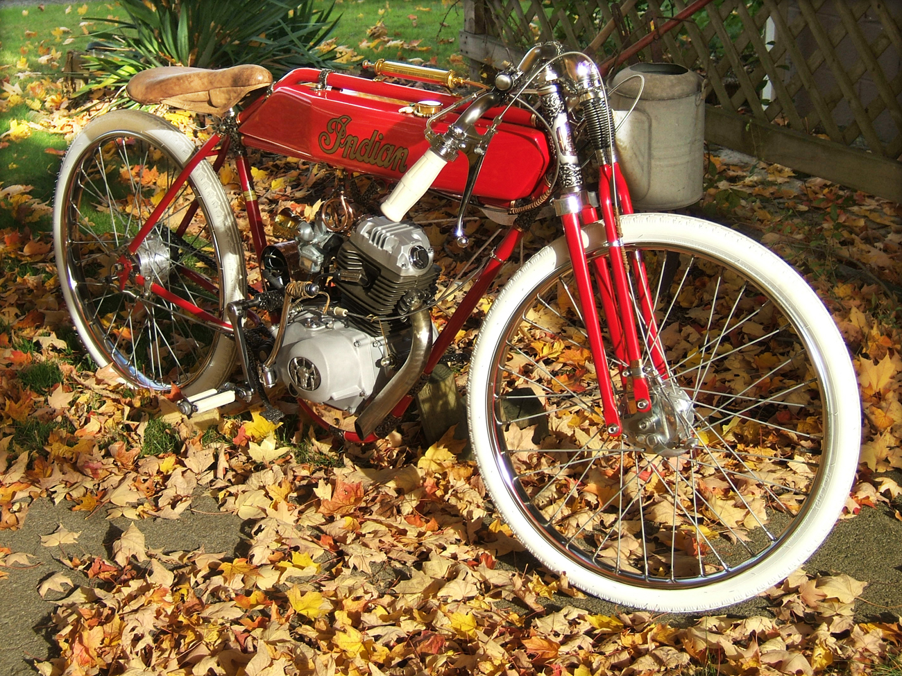

Yes it will fit, I had to spread my original set slightly to make it work. Keep in mind these forks were designed for a bicycle, depending on how much weight your adding to your bike might make a difference on the operation of the fork. My bike is pretty heavy and the springer really does not operate as it should, I'm looking into adding a different spring set up or a helper spring to the original.
