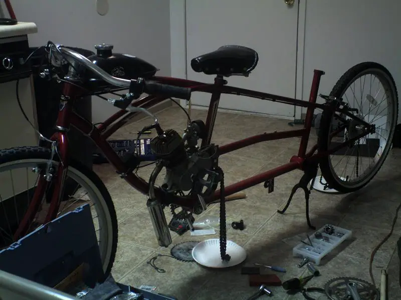

I'm trying a 80cc 2 cycle on my tandem project. It's a "sun retro cruiser" and they are no longer made. I tryed very hard to find this one. I bought it off of some guy on craigslist for $250. I think were $800 new. I'm running the motor chain through the bottom bracket of the rear passenger. It's been a pain. I'm not planning to have a second passenger, sort of a stretch lowrider looking thing. If I were to do it again I would of just bought a shift kit from sick bike parts. Once this engine dies (any I have a lot of miles on it) I think I'll put a 4 cycle on it.
