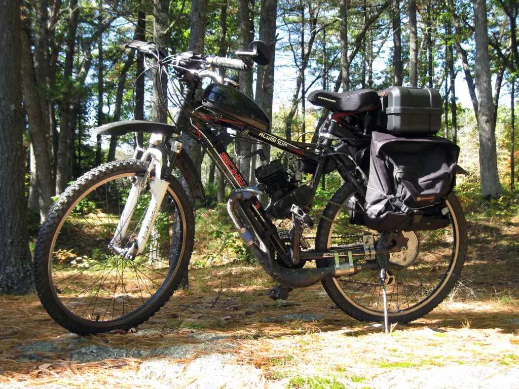

Saddlebags? Gawd - I dunno what I'd do without 'em lol I commute with my bike and do grocery runs, heck - it's all I drive My main transportation because I hate the daily costs of a conventional vehicle (those schwinn bags are garbage tho, need better ones);
