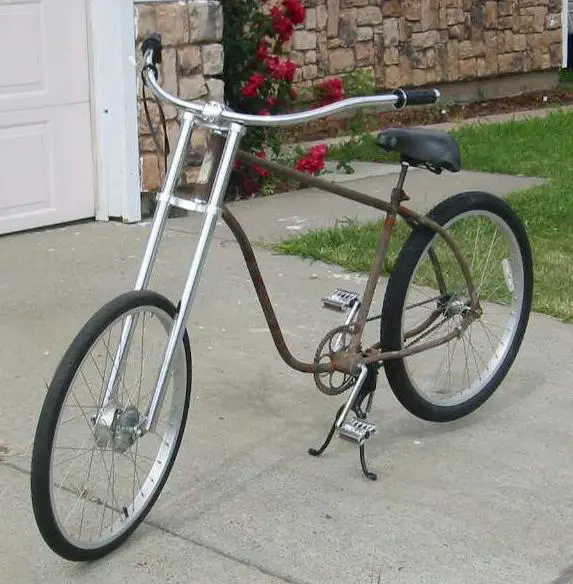

Hello Marair23, I did a couple of "stretched" bikes a few years ago. But, some things can get kind of goofy when working with bicycle frames and at the point I had done this one in a traditional "chopper" style 6" out and 5" up I was seeing that. This bike is very long, the forks are 43".

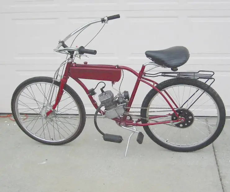

The red bike with the Chinese 2-stroke was the last of that sort I did. This pic was resized in November of 2004, Chinese under frame tank, ladies cruiser I made the sprocket from a bicycle sprocket (much more "round", I have a few of those left 44 teeth, tho they are not drilled with the large lightning holes.) This bike is stock Cruiser wheelbase. I am currently looking to do another bike, and may re-cut this one to be a different animal.

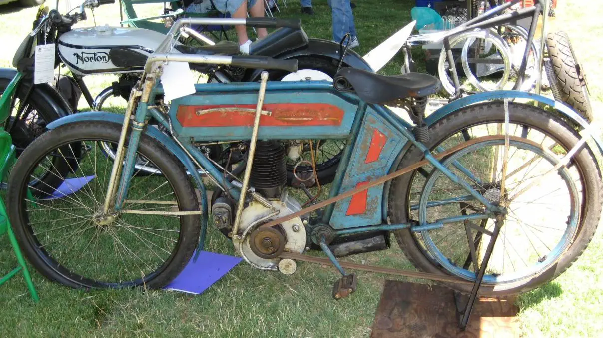

The wheelbase (axle to axle) on this blue Original 1910 Excelsior measured about 53". Having the information I now have, I will use as many original dimensions that I can.

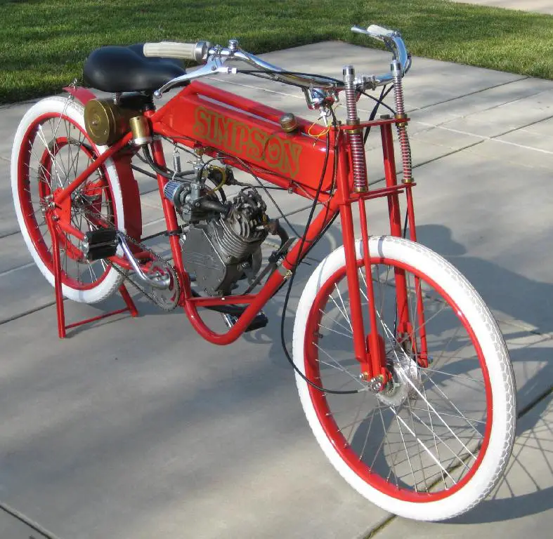

This Red Racer is a little short on rake, and might be an inch taller than it could be, however it is close.

Dude, the builder was Excelsior.

That 53" wheelbase is for a full-sized production motorcycle of the day.
You can assume most used 28" wheels(some had 26"). Since 26" wheels are commonly available now, you can resize accordingly giving roughly a 92% scale.
.929 X 53" = 49 1/4" wheelbase to give you the proportional sized frame for a 26" wheel bike.

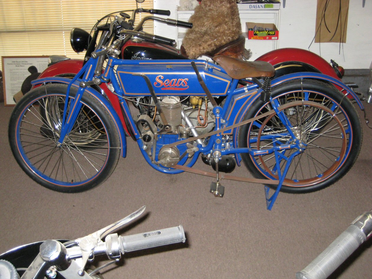

Hi Guys, that Excelsior is a fine "Barn Bike" runs well, and was entered in the Antique Motorcycle Club of America's Concourse D' Elegance a couple of years ago. This one is a 26" wheel model, and yes in 1910 Harley also offered the bikes with 26x2.125 or 28x3. Many pics and the movies I have seen of early board track bikes were the 26, not the heavier 28's.
I have a bunch of other pics of fine Veteran Motorcycle I took that year, and a couple of other years. The reason I showed that "X" is because that was the first one I measured.
Excelsior won many races, and awards for the period of time they were involved in Board Track, Cross Country )an early open-road racing type, and even Hill Climbs. In the day, the Mighty X was often the one to try to beat.
The blue Sears is an outstanding bike, about 1909, again the 26" wheels, and a strange articulated frame.

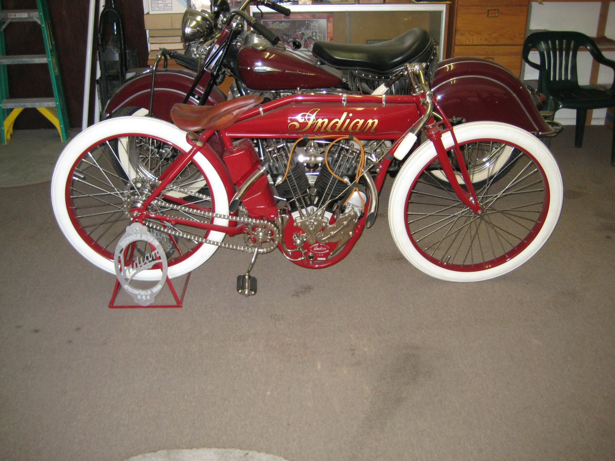

i just noticed the exhausts on that indian. i wonder if asbestos pants were needed to ride that.
