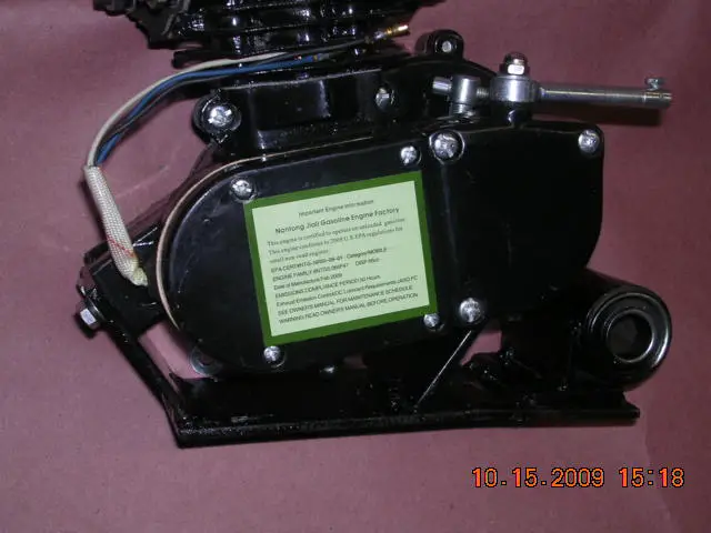

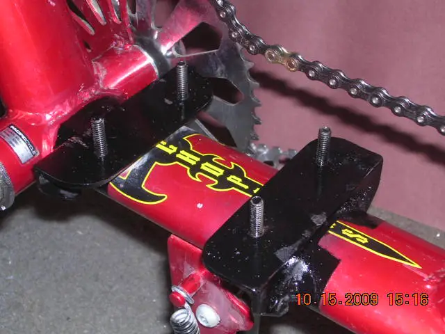

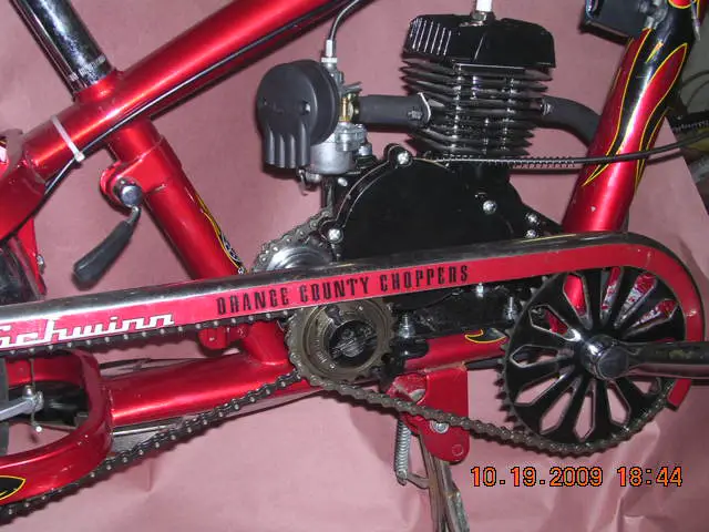

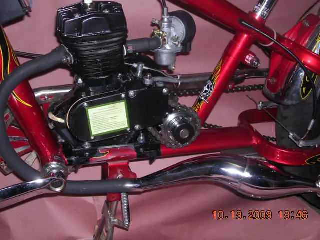

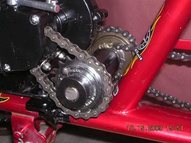

I was looking for an easy way to mount a DIY jack shaft.
This is what I ended up with.

that's pretty slick !!!
nice n compact

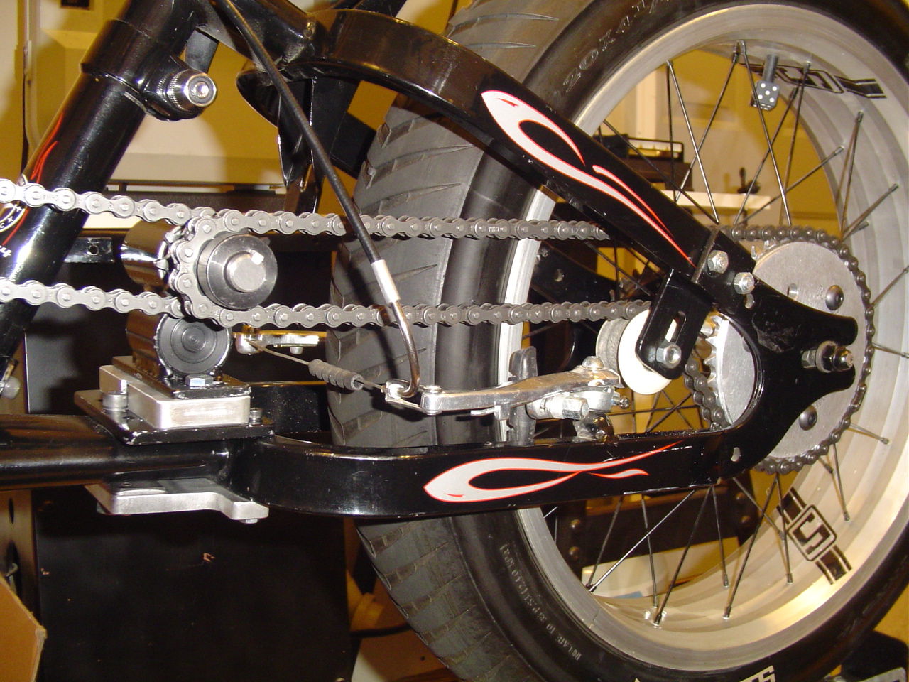

I see I am not the only one that put my engine on the centerline on the OCC. That jack shaft set up looks real similar to mine. I used Chromoly tubing and the 5/8 x 1 3/8 bearings.

Russ nice clean setup. Do the pedals turn with the motor or does that spocket freewheel?
Retmachinist,
Just wondering why you didn't go multi speed. That was the object of my project. I monitor all your posts. You do some good work, but then I'm used to being around machinist and toolies!

Bandito,
I bought the bearings and shaft on line ($40), the bearing sleeve is 1-1/4" black iron. The pedels freewheel. The motor also freewheels with the clutch engaged, because I was going to pull start only. Now I think I'll weld the motor freewheel so I can also bump start also.
