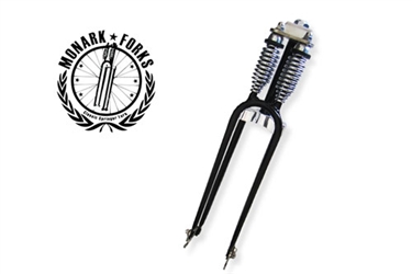

I have a 26" electra beach cruiser and I was thinking about adding springer forks instead of the normal forks before I order a kit motor. I was reading in some other forum that its a much more enjoyable and smoother ride. I need some advise from someone who knows there stuff. Please let me know.

It isn't by any means mandatory, yet it's true a front suspension makes for a much more comfortable ride. They're also groovy lookin' lol I'd be cautious though, some of the cheaper ones look like an accident waiting to happen with crimped ends and pivots, extreme length and/or bends.
There's some folks here that have rebuilt their low-cost springer forks to have sleeved pivots etc. and that's an option - but these look like quality forks, a lil pricey tho;

from what i've been reading around here is that springer forks ain't all they're cracked up to be for motorizing.
those cool looking monark repro's up there that barelyawake posted? well, everyone i've asked that uses them has said they tighten them down so much that the spring is about useless.
the "lowrider style" schwinn repro forks look like they were built out of a screen door, using a vice and a hammer as the tooling mechanism. i wouldn't even trust those on a bike without the motor. in fact, if they were still a screen door, i'd be afraid it'd slam in my face.

Hmm... I wonder if those monark repro's would be any better with dual-stage "progressive" springs - or do they tighten them up so much cause they're made floppy?
Heh - I suppose there's a reason we replaced them with pneumatic/hydraulic
Still, I like the look despite my mountain bike ways and if I ever got a springer bike that one is prolly the highest quality I've seen, short of custom jobs.
