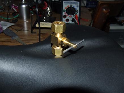

Default Re: Gas valve/
from the tank to the valve its all copper. a inch of copper after the value its rubber gas line to the carb.
only rubber in this valve is around the handle rest is copper. kinda give it that old school look
and the best part i can turn off the fuel ;( i took apart the included gas valve that comes with the kit. do they really think that will stop the fuel? talk about cheap.
im just a little pissed now i need to fix my floor. even if i had a garage its still a fire hazard..
