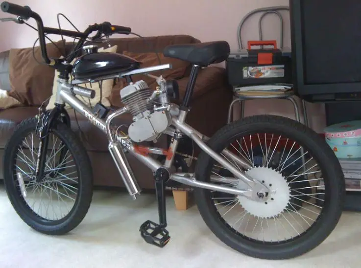

hey guys, while camping in donnybrook for a few nights with freinds, i was able to ride a few quad bikes and 2 wheelers. anyway i came home and went for a ride on my 31cc ryobi bike and i was hating it, i guess when i was riding them 400cc quads around something must have triggered in me and now im addicted to power. well my new project is going to go like this:
80cc chinese kit used on 20 inch bmx with the kit sprocket going to the left side of the pedal shaft and on the right side of the pedal shaft going to a 15 tooth bike sprocket then to the back hub with a derailleur setup from a mountain bike, 1st gear i want to be supper low so i can start riding on a hill and the 5th gear i want to be overdrive so when im upe in exmouth i can fang along the ocean roads to get to the beach.
now your asking why a bmx? well i think its worth the trouble because i want something sporty, that i can do tricks and stuff like that, basically i want to make a equivalent of a bmx motorbike.
this is were im going to mount the engine but with front tube supporting tubes, this is not my bike

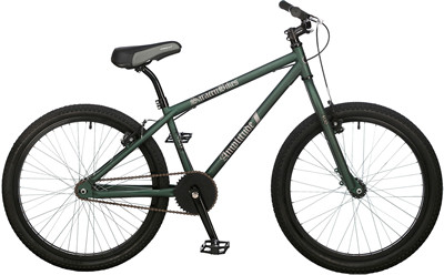

My criteria for my ongoing build is very similar, it needs to be tough enough and small enough to be able to hoon around. So like the other guys have suggested to you, I have gone with a 24" dirt jump bike build, the frame is a saracen amplitude 1, the engine that is going in is a Cag (pocket bike motor). the cranks I am using are BMX 3 piece cranks (gusset pigmeys) and the Forks i plan on using are a long travel 150mm single crown (manitou stance blunts). It is to be a single speed, geared similar to a BMX as the engine will never have the torque my legs do but the engine itself should propel the bike to 35-38mph with the gearing i have worked out.
With a few alterations in spec I think this would be the kind of build your looking for?

YOURS:  MINE:
