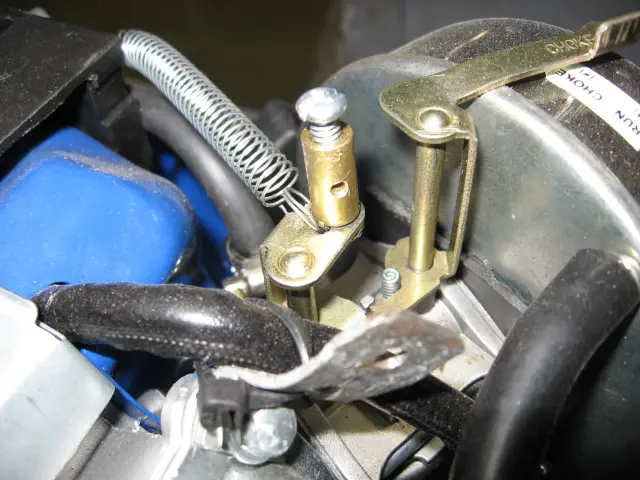

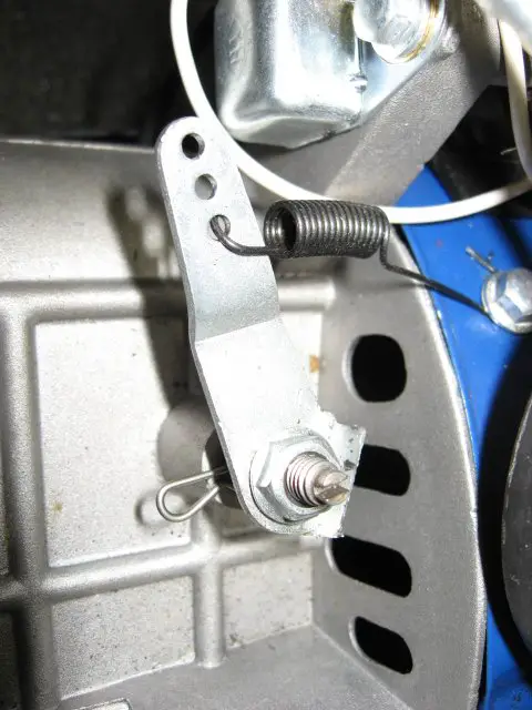

I disconnected the governor linkage and fabricated a bracket that bolted to the valve cover bolts. I ran the throttle cable through the bracket and connected it to the throttle lever of the carb. I used a brake cable clamp that I attached to the throttle lever to anchor the cable. I will try to remember to take pictures tomorrow. I will update this post then.
Jim
Here are a few pictures. The first picture is the throttle and the second picture shows what I did with the governor. I used the spring to keep tension on governor parts in the engine. As the engine revs up the arm pulls on the spring like it would if the linkage was still connected to the throttle. In case your curious the air cleaned is from a 2000 WC-1 Whizzer. It took a little work to make it fit but it was worth it. I like the look.
