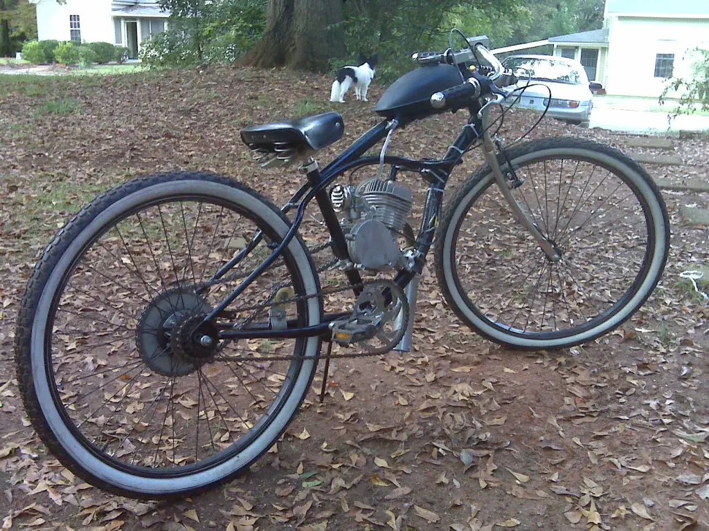

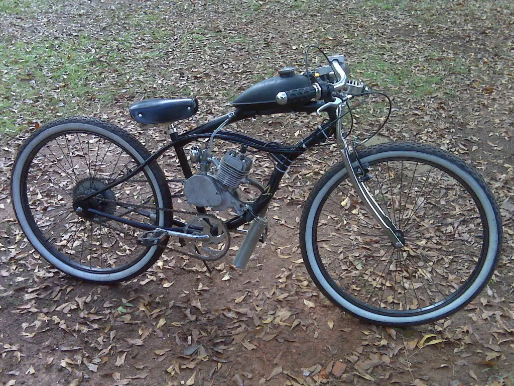

Just wanted to say Thanks . I started this week off really wanting a top tank moped . I'm fortunate enough to be in a community that is all things bicycles and scooters ( athens ga ) - well after getting a rolling chassis of a '78 Pacer super sport on monday for free from a local scooter shop , I decided it was a bit more work and money than what I wanted to throw at it . I gave up and moved on to what I have today . The local scooter shop assembled an MB for a customer , after 7 mos. the customer had still not picked it up . I gave them 50 bucks and was on my way ! It was mounted on a crapola - ready for the trash bin rusted Free Spirit MTB from the 90's - so I disassembled the bike . I just happened to have a Mongoose Justice on the side of my house that would be the perfect starting point for my project . After reading pages and pages of this forum , I realized I needed a universal front mount . I ordered from SBP ( on Wed it was here today ) my ride is finished , just took it out for a spin and its even more than what I anticipated, since I knew all the pitfalls that go along with these ( thanks to all of you and your experience ) . Below are a few pics . Sorry for the long drawn-out intro .... I just wanted to thank everybody on this forum - you guys seem like a good bunch .Looking forward to the next build and mingling with you all . until next time

that's kinda what I thought ....
- so far so good trying to run out a tank gas out before tomorrow ,since I'm not leaving the neighborhood in fear of the flying chain tensioner , it may take me a bit longer . The only thing that's happened so far is the chain falling off . no biggie - may have to get the tensioner welded or something - it would be nice to do a few miles and not have to worry about it . I haven't really noticed the vibration everybody talks about . I really thought it was going to beat me to death like an ancient mini bike . Thanks again guys - glad to be here ...
