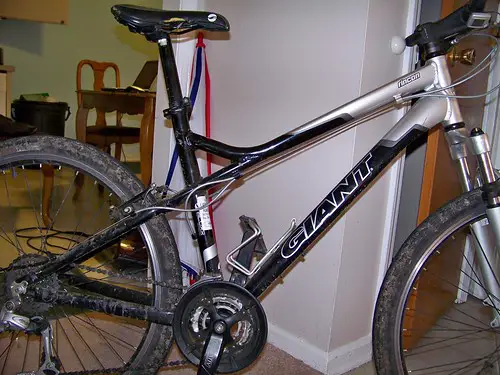

Hey guys, I've been thinking about doing a gas engine for my bike for quite some time. I have some questions.
My Questions
Will this new frame work / is it the best solution considering i'm already changing the frame?
(I do not want to go with a cruiser style, if possible)
Which kit is best or close to best considering my options? I'm not going to fret about a few dollars, just as long as its under $200 total.
Is a slant engine preferable? (torque is preferable to me)
Should I go with multi speed engine? Or perhaps even a dual start?
The bike I have a 2006 Giant Rincon but I'm almost positive that frame won't work so I'm going to switch it out to a standard frame
I'm looking at these kits, honestly I don't care which one I get (but the multi speed interests me) I just want to know what you think will work the best.
Since I can't list links, the engines are listed at (kings motor bikes . com) and (the la shop . com)
Black Flying Horse 66cc/80cc Bicycle Engine Kits EPA Certified
Grubee SkyHawk 66/80cc Angle Fire Bike Engine Kit EPA Certified
Grubee SkyHawk 66/80cc Bicycle Engine Kit EPA Certified
80cc 3 Speed Dual Brake Gas Bicycle Motor Kit
80cc Black Engine Dual Brake Gas Bicycle Motor Kit
80cc Dual Start 3 Speed Dual Brake Gas Bicycle Motor Kit
Also, jet engines are fine as well

The Giant may work - but they're known to have... well "giant" Dtubes and this may make installation difficult. If you have the room then it can be done - pics would help us

I would like to stay with this frame if its at all possible, so If I can use a 80cc engine thats preferable. Im not sure i'll even be able to mount a 49cc on it though. I would want like to find one with the smallest footprint possible.

Secondly... there's no real way to mount an in frame kit on that bike in particular as there's simply no room at all, my build has a similar frame style for the top tube at least and even though it has a LOT more room than yours it was a very tight squeeze.
I'd say you have a coupla options. You could look into rack mount engines or electrics (both quite costly, starts at about $400), you could get a bike better suited for an in frame kit - and/or you could find a donor frame and swap out the better components from the Giant, which is prolly the cheapest route.
I know they're crappy, but many Wallmart bikes actually have really nice frames (look at the welds to judge quality) but they cut corners to lower the prices by bolting on the shoddiest mechanicals possible. You could get one and swap out all the really nice bits from your Giant. I'd go with that method if you can't find another bike/concerned about yer pennies.
Sorry to be the bearer of bad news, but all is not lost - just a minor setback is all. Keep us posted and good luck in yer quest
Edit: lol, I just re-read yer OP sorry man - sounds like you've the right idea after all! Ya got any pics of the other frame?

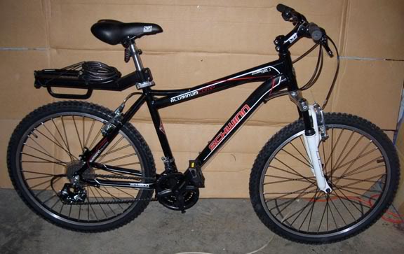

This is the bike I started with and although I had quite a bit more room, it still wasn't enough and was a bit of a nightmare lol (the "dropped" top tube is sneaky) so I'd advise a standard (preferably steel) V frame for a first build;
