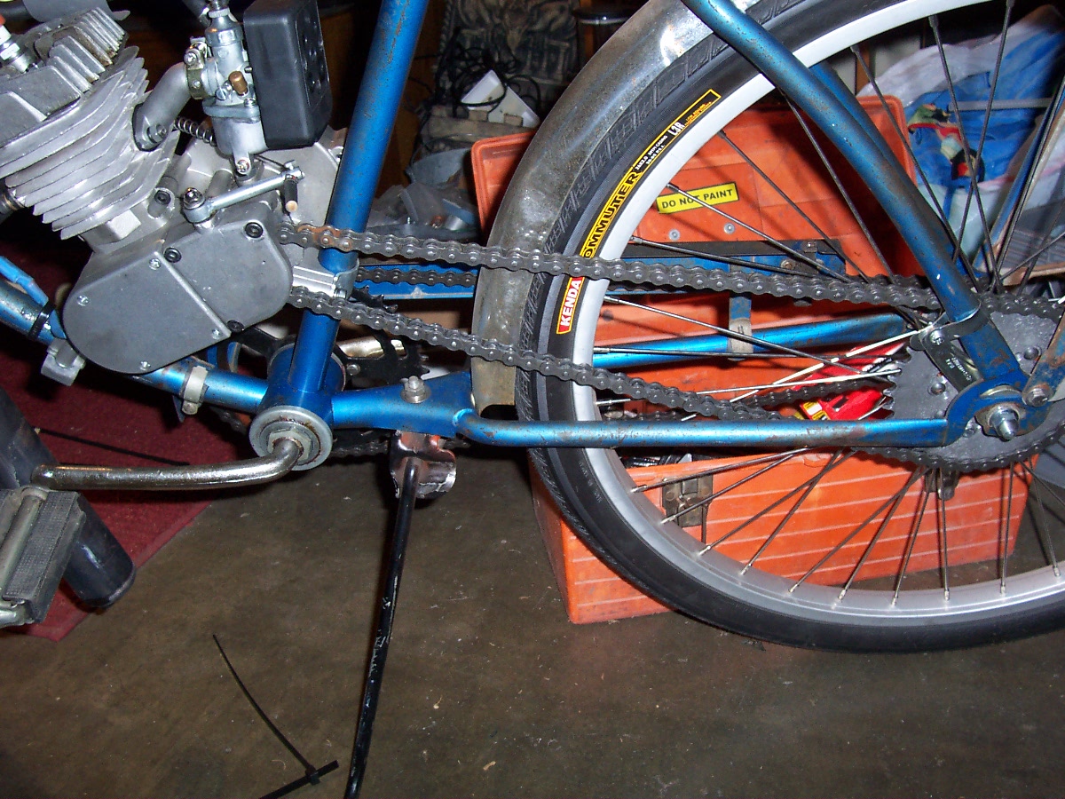

oh ,and, there's other ways to hook up your coaster brake arm...
Name:	chain tensioner 003.jpg
