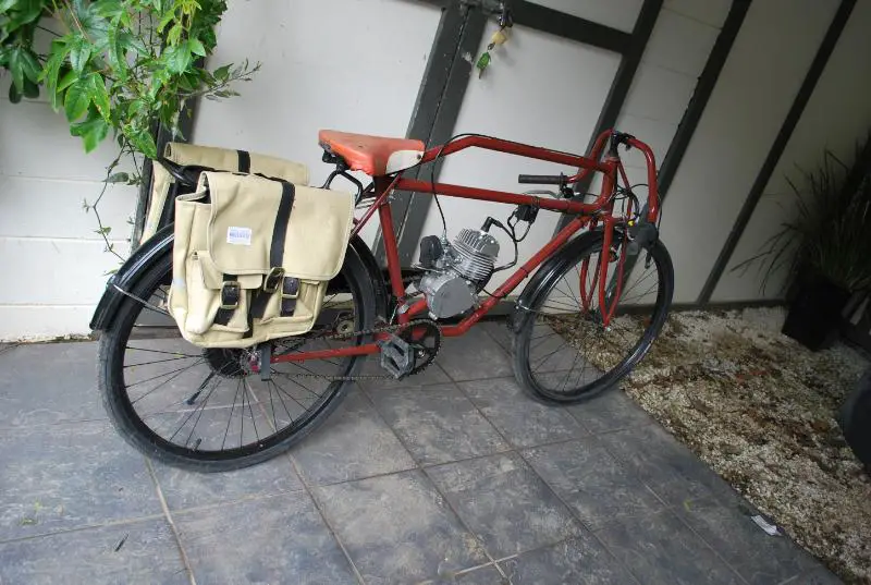

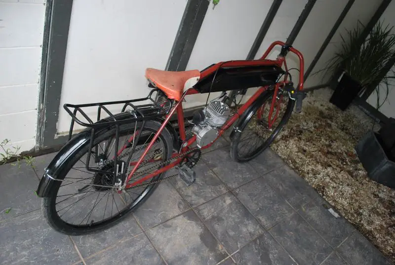

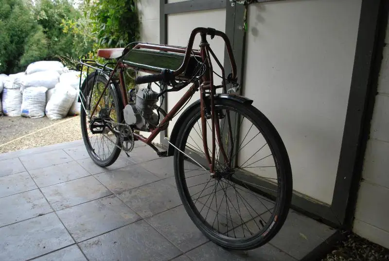

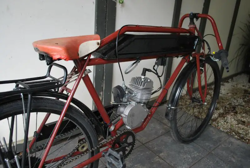

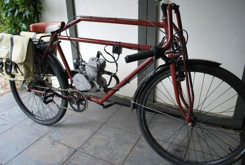

Hi Guys,
just finished my 2nd boardtracker, finally got the geometry right for a bigger lad such as myself 6"2' and 100kg!!
custom 27" road frame, lengthened and lowered, custom 4litre fibreglass fuel tank, 66cc motor, tuned exhaust, bigger carby jet, built in chain tensioner, front Avid V-brake, alloy rear rack with old school pannier bags..
very fun riding position!!
anyway here are the pics
enjoy

the tank I made from fibreglass and MDF,
however the fuel seems to be breaking down the resin and causing some headaches so I am making a steel one atm, using a 90x90x2.0 column from my building site, weld a cap onto the end and tapered the other end (seat post end) for a well sealed and non corrosive fuel tank!!
i much prefer steel as fuel cock and fuel filler will eb 100 times easier to fabricate and painting will eb a breeze!!!
