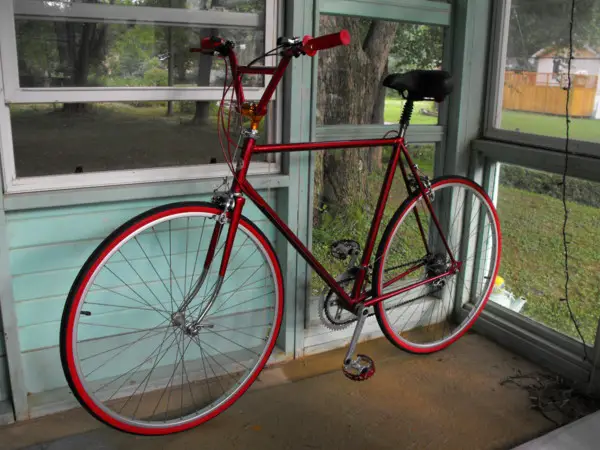

Here's pictures- the cruisers been changed now but I haven'tr built the Schwinn- for that I have a narrow sproket and smaller chain and ultra-light 34 tooth sprocket for the ground down strandard hub- with alloy wheels I'm expecting the finished weight to be not much more than 35 pounds.

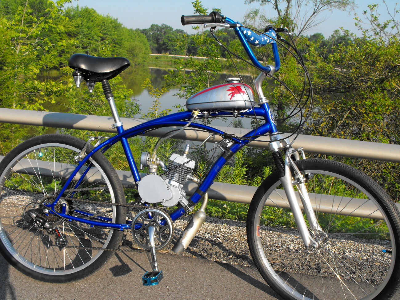

I plan to get some saddlebag baskets for the cruiser to use for just the type of riding you described- but strictly fair weather- hate fenders, except in guitars! New blue 27" tire on the front looks awsome and rolls even better!
I might take the derailleurs off the Schwinn if I build it up, and have a 22 tooth freewheel for the pedal side, to save weight and still give an easy pedal- but no plans to order a kit there yet.
These are loud- I've started extending the pipe with an ordinary aluminum can and hose clamps, with end drilled some- and it makes a difference
I find the BMX bars give a better perpendicular grip, without being as extreme as stingray bars. And they look cool, but be careful of the size!
